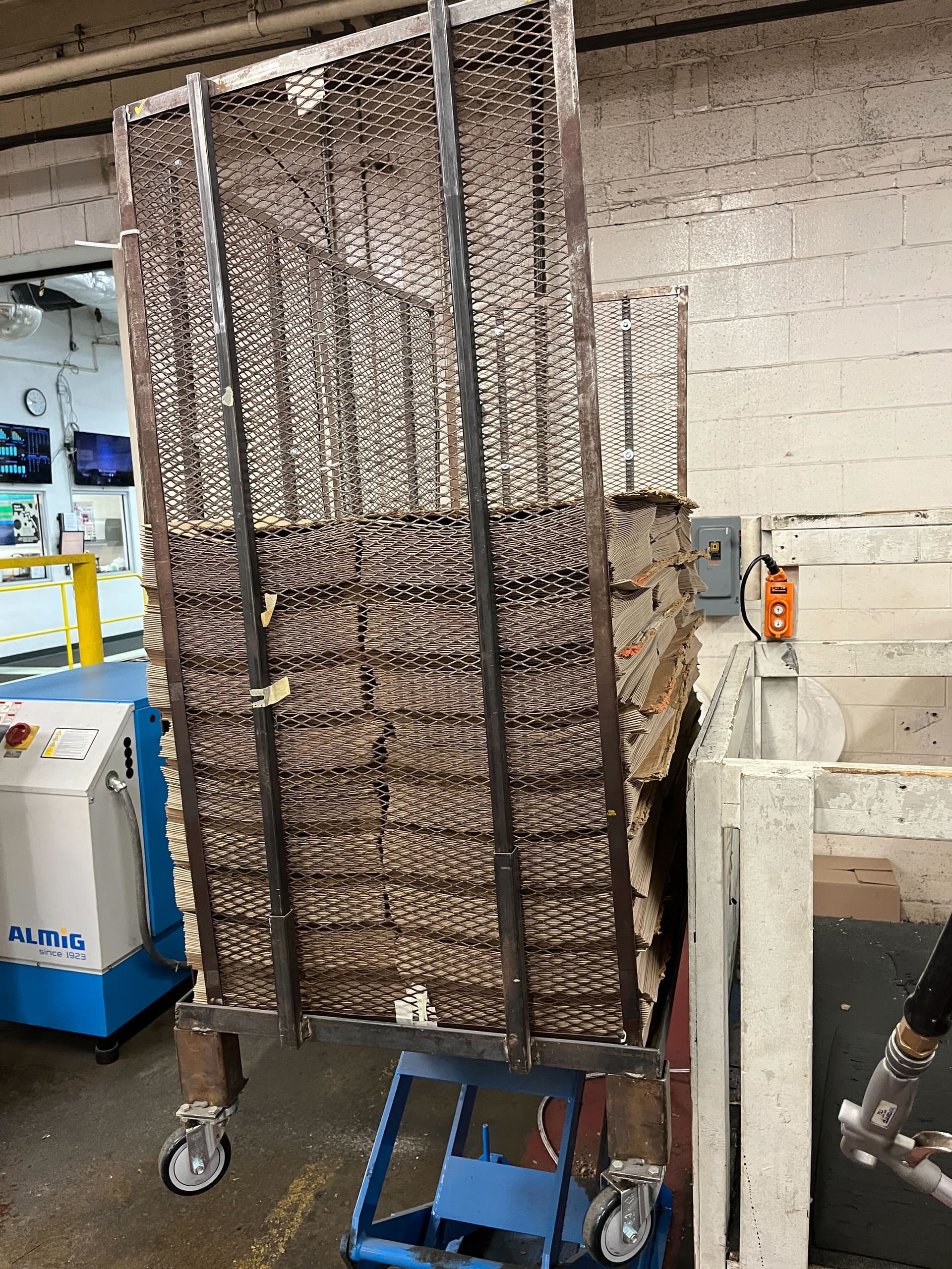

We use carts to hold product between operations. It’s hard for operators to know how many finished cases are on a cart at time and we run into issues with over/under run and qty reporting timing. We’ll have product finished on final operation before we get the stuff reported on the first one which confuses #WipIsGarbage.
We don’t really need per bag accuracy in count but that would be great if achievable. Really I’m just looking for a way to show them how many cases of 250/500 are on a cart at a time so i’m weighing in LBs not OZs at that point.
Whatever the scale is as long as I can read the weight to a PLC for calculating count from the weight and perform my qty reporting in Epicor from there I will be happy.
Anyone have experience with this that they can share?
