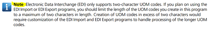

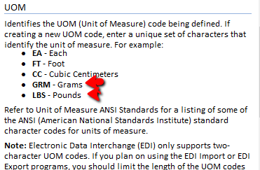

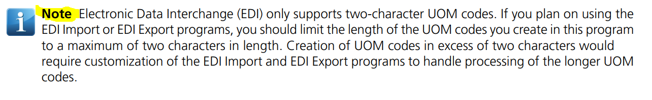

Epicor does list the ANSI UOM Standards in their UOM TechRef Guide, I assume for a reason.
Im working through a similar issue. Im recommending we use ANSI here (I have been using that same document that you attached).
We plan to use EDI and i want to make sure that we dont have any trouble in the future. Epicor UOMs are too difficult to change once you have a part tran record.

The best option is to follow ANSI and I am sure for anyone who has plans to do EDI, Epicor has ANSI to Non-ANSI (ISO…) Converters easily available.
Funny how Epicor suggest ANSI, yet in many examples they don’t follow their advice.
