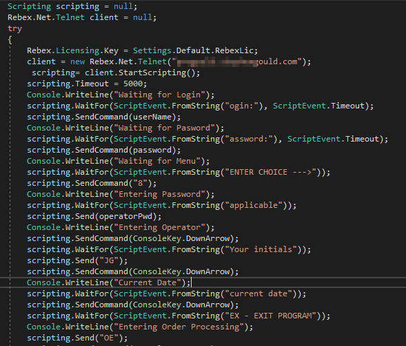

Don’t give me any ideas! We do have a current integration that mimics telnet via send keys to extract data from one of our system so I could go that direction too… :thinking:
