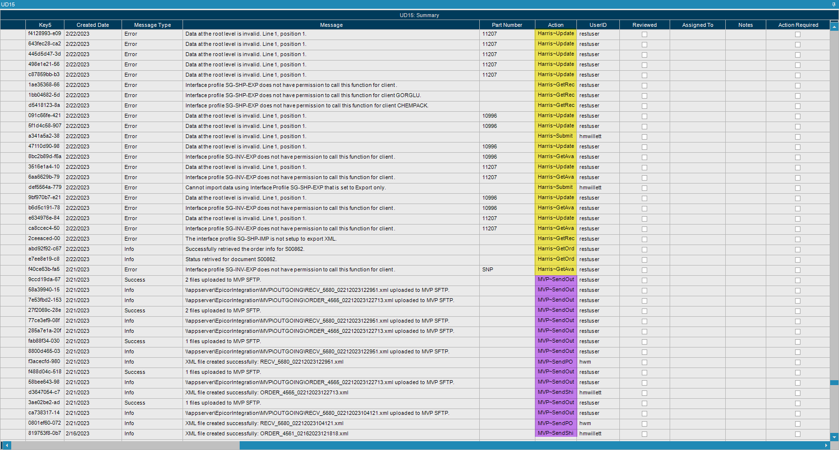

Okay word so are you just writing updates to UD table at each try catch in the integration? Or whatever error handling/logic points that make sense?
Yup.
For example:
                  if( vSku.Trim().Equals("") )
                    string whse = (
                      from w in Db.Warehse
                      where w.Company == Session.CompanyID &&
                            w.WarehouseCode == whseCode
                      select w.Description).DefaultIfEmpty("").FirstOrDefault();
                    headerKey = line.ship.PackNum.ToString();
                    detailKey = !Type.Equals("MiscShip") ? line.ship.PackLine.ToString() : line.deets.PackLine.ToString();
                    messageType = "Error";
                    message = "Part number " + pNum + " does not have a vendor part cross reference in warehouse '" + whse + "' (" + whseCode + ").";
                    partNum = pNum;
                    userID = !Type.Equals("MiscShip") ? orderInfo.EntryPerson : shipInfo.ship.EntryPerson;
                    this.EfxLib.TPLIntegrations.WriteToUD15(source,
                                                           direction,
                                                           headerKey,
                                                           detailKey,
                                                           messageType,
                                                           message,
                                                           partNum,
                                                           action,
                                                           userID);
                    continue;
And in the catch:
  catch(Exception e)
    Success = false;
    ErrorMsg = e.Message.ToString();
    InfoMsg = "";
    TPLRef = "";
    headerKey = shipInfo[0].ship.PackNum.ToString();
    detailKey = "";
    message = e.Message.ToString();
    partNum = "";
    userID = !Type.Equals("MiscShip") ? orderInfo.EntryPerson : shipInfo[0].ship.EntryPerson;
                                           direction,
                                           headerKey,
                                           detailKey,
                                           messageType,
                                           message,
                                           partNum,
                                           action,
                                           userID);
And everywhere else that I think it might be beneficial to have a message to act upon or know.

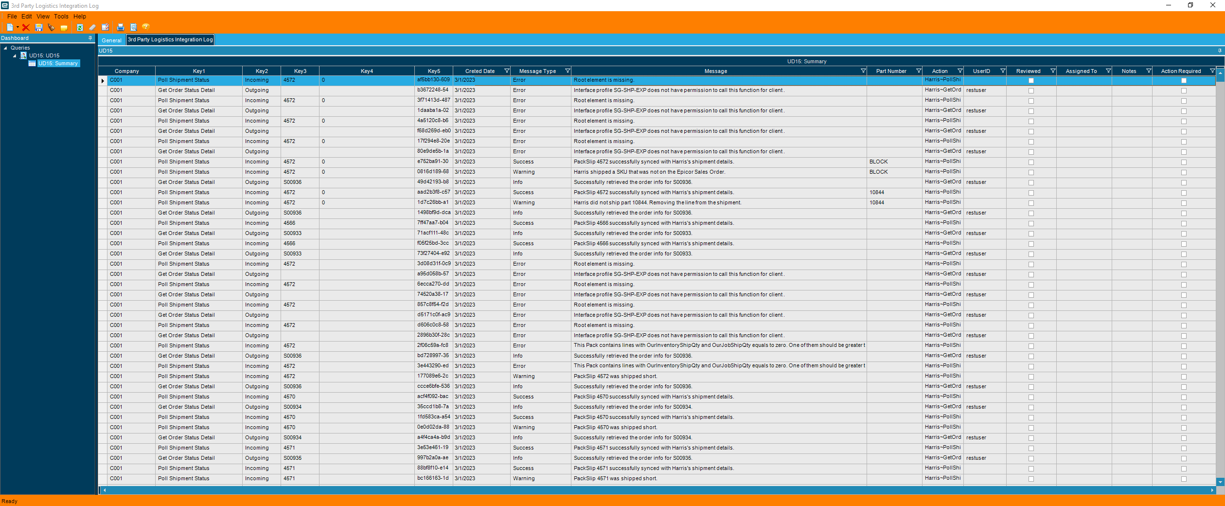

Thank you, okay. I like the function call too. Last I checked though if I want to do it on a form I have to make a rest call since I don’t have a business object that I can use.

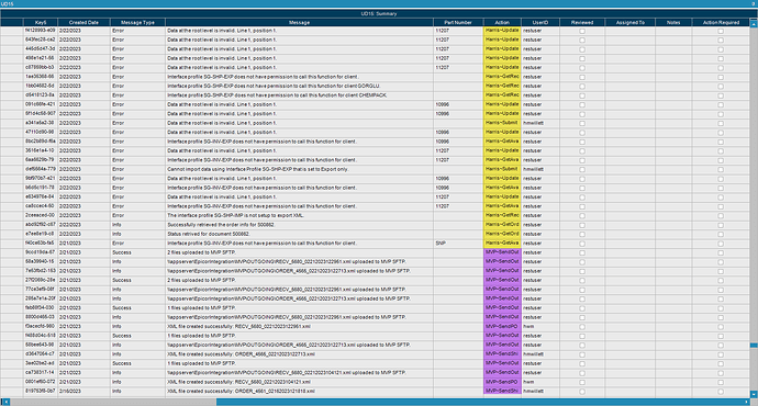

This is an agnostic log table as well. I have every 3PL logging to this table and can be filtered on the Action column which shows Library~Function.
You can see the exact day I started working on a different integration, lol.
Okay cool, thanks a ton for an example of how you are successfully doing it.
I just didn’t know if I should log in database, log on client, etc.
I chose the database so that I can put the onus back on the users if it’s something they can act upon. Like–errors of the integration is something I will have to deal with, but if it’s something like a line shipped short–that’s on them. They can then make a dashboard and work from that vs having to go look up a log file on the server and deal with that.
