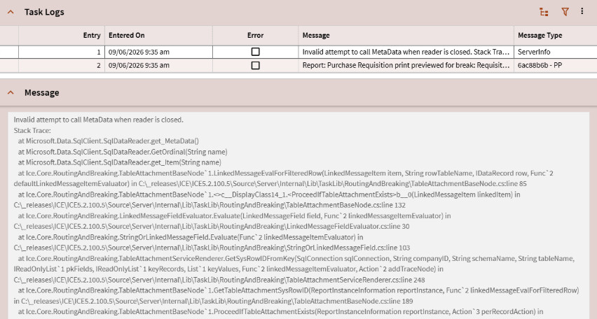

Do you faced an issue when preview the report with Add ECM Attach action in report style breaking/routing?
The error message similar like below screenshot:
