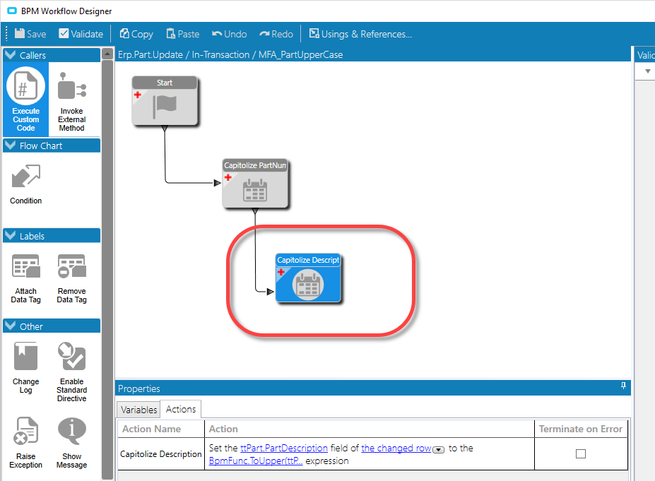

Yes I also added a Set Field widget to change the description to upper case.
This seems to work great, I even added a new part with our CAD interface (CADLink) and it capitalized the part number and description in that case as well.

please do yourself a favor and don’t use that BpmFunc I beg you. Just replace it with .ToUpper() seriously those helper methods were added to supplement people that don’t know or understand .net and needed to use their old ABL style code.
I agree with @josecgomez, I ran into issues forcing capital letters on state abbreviations with this.
BpmFunc.Today() jacked my dates up too.

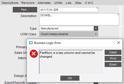

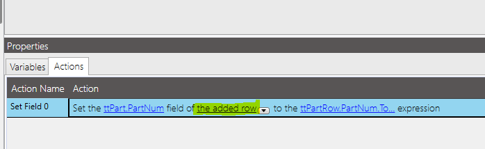

you need to add a condition to check the RowMod status, or apply this set for Added rows ONLY, i.e. your BPM will error out when trying to change ttPart.PartNum for an existed Part record.
Ok done! thanks. (still works)
