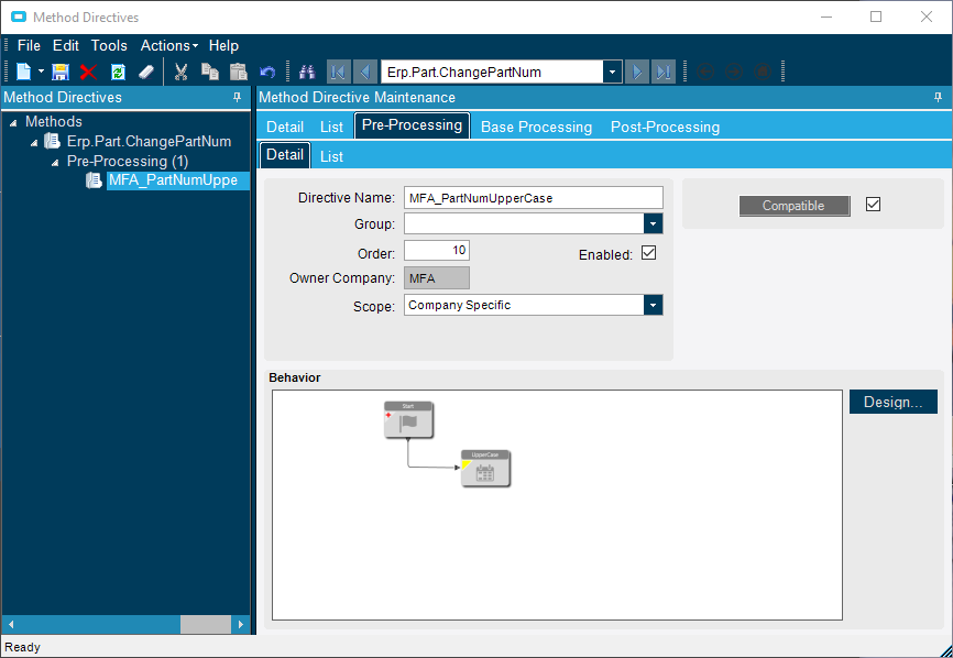

Ugh - can’t get this to work! I did what you said.
Here is the workflow designer:
And here is the C# expression:
I checked syntax, validated it, saved, closed Epicor and restarted and does not seem to be working. It’s marked as ‘Enabled’.

ChangePartNum takes in an input parameter apply it to the parameter instead of the ttPart
I think you’re better off putting that on the data directive. Do an in transaction and set the field the same way on any added rows.
That method (ChangePartNum) is behaving oddly.
