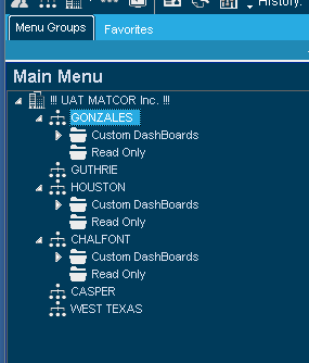

Just make the 1st level menus (Sales Mngmnt, Service Mngmnt, …) disabled. Underlying menu items are still enabled.
For example I made a group (“Disallow all”), and set the security for Sales Mngmnt, Service Mngmnt, Production Mngmnt, Material Mngmnt, Financial Mngmnt, and Executive Analysis, by adding group “Disallow All” to their respective Disallow lists.
Now users belonging to Group “Disallow All”, see:
If I launch a dashboard in Custom DashBoards, that has a P/N field, I can still open Part Maint or Part Tracker. Even though those menu items are in a sub-folder, of an excluded folder.
Here’s what my test user sees when using the desktop client (after I’ve added their group to the Disallow list of all 1st level menus).
No sub-menus show for any site.
Here’s the same user on the same computer, with MES launched:
And you can see that the menu item on MES can be launched.

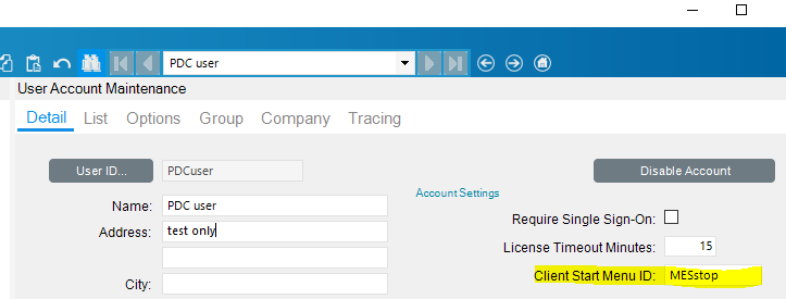

I think your thought is the same as one I had, which is make the full Epicor (not MES) useless for them.
What I tested was similar, but I just set the user’s “Client Start Menu ID” to an empty folder I made (pic below). So the menu opens to nothingness.
Problem is that my users still have links on their home pages to screens. And useful BAQ tiles. I’m not quite a jerk enough to go and delete all that. I guess I have to commit if I really want to be a dictator.
