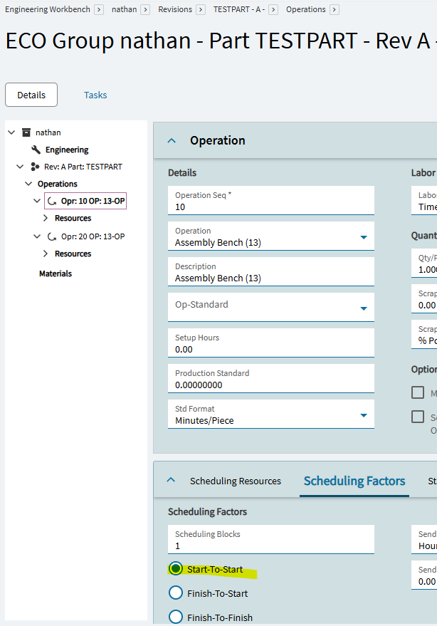

I’m not sure, but try setting both operations to Start-to-Start. They might get scheduled on top of each other. Good luck!
