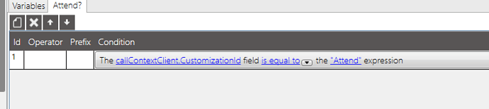

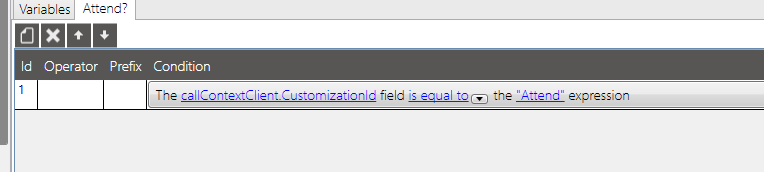

I have something very similar to this. I use a table for HR documents and use a couple of entry forms to enter them. I use a post processing method directive on GetANewUD17.
Mine’s fairly in depth but to give you the highlights that will help you.
I use conditional statements to determine which form entry it is coming from.
You can then use custom code to set the key field that you want. I highly advise making sure you that your key fields are unique. I use a UD field on the JCSyst table for this that is an integer that I increment and use for the first key.

In my case, Key1 is the integer that I am incrementing to make sure my key is unique.
Key2 is set to “2” on if this is called from the “Attend” customization. Then when I query this database, those with Key2 set to “2” apply for Attendance documents. (“3” is Time Off Requests, etc.)
