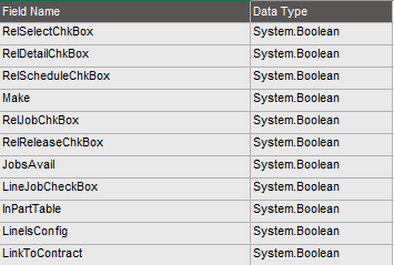

Here is the list of possible fields. I would offer that you have selected the wrong one (although I have not run a trace):

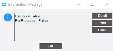

Did a little more testing, checked the values of RelReleaseChkBox and JobChkBox using:
foreach (var ttJWOrderRel_Row in (from row in ttJWOrderRel select row))
 string RelJobChkBox = ttJWOrderRel_Row.RelJobChkBox.ToString();
 string RelReleaseChkBox = ttJWOrderRel_Row.RelReleaseChkBox.ToString();
this.PublishInfoMessage("RelJob = " + RelJobChkBox + "\nRelRelease = " + RelReleaseChkBox, Ice.Common.BusinessObjectMessageType.Information, Ice.Bpm.InfoMessageDisplayMode.Individual, "", "");
and got this for each row… well now I’m really stuck haha
