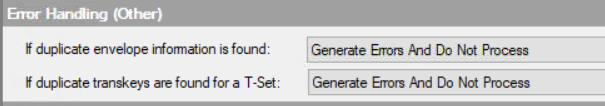

Second doubt:
If I Import one EDI of demand contract number and PO today…suppose I have to import same EDI with slight difference in qty on the same day itself …Import log is not showing demand demand detail and Demand schedule rows are created…it is not creating rows for second time if we import on the same day itself…why ? can we set some where in the epicor, is it that , do we need to import EDI after 24 hours?
