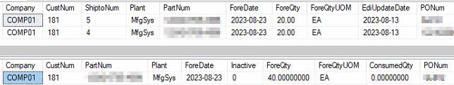

SELECT * FROM Erp.ForecstDtl fd WHERE fd.CustNum = 6651 AND fd.PartNum = '5103758' AND fd.ForeDate = '01/23/2024' ORDER BY fd.ForeDate, fd.EdiUpdateDate ASC
I see the following results:
When I open that part up in Time Phase, I see this:
Time Phase is only showing a demand of 1,500 for 1/23/2024, while the ForecstDtl table of the Database reflects a Forecast Quantity of 3,000.
The ForecstDtl Table shows a quantity of 3,000 (1,500 per line), but Time Phase only shows 1,500. Is this something that indicates that we are processing our EDI transactions incorrectly perhaps? Is there another primary key I should be looking at in ForecstDtl that is not registering in my mind for some reason?
We don’t consume forecasts yet, but I had a bunch in demand entry so I processed some of them. If I have the same custnum and partnum like you I do get two ForecstDtl records, but I get one combined quantity Forecast record that shows in timephase.
I tried to make two same day same part forecast entries and forecast is constrained by custnum, part and date, so you can only have a combined forecast record for all forecast details for a customer, part and date.
