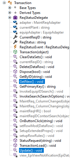

I believe the code would be oTrans.GetNew() and oTrans.Update() instead. I don’t have access to a system with that license, but if you use Tools > Object Explorer, you can see the list of Transactions that are available.

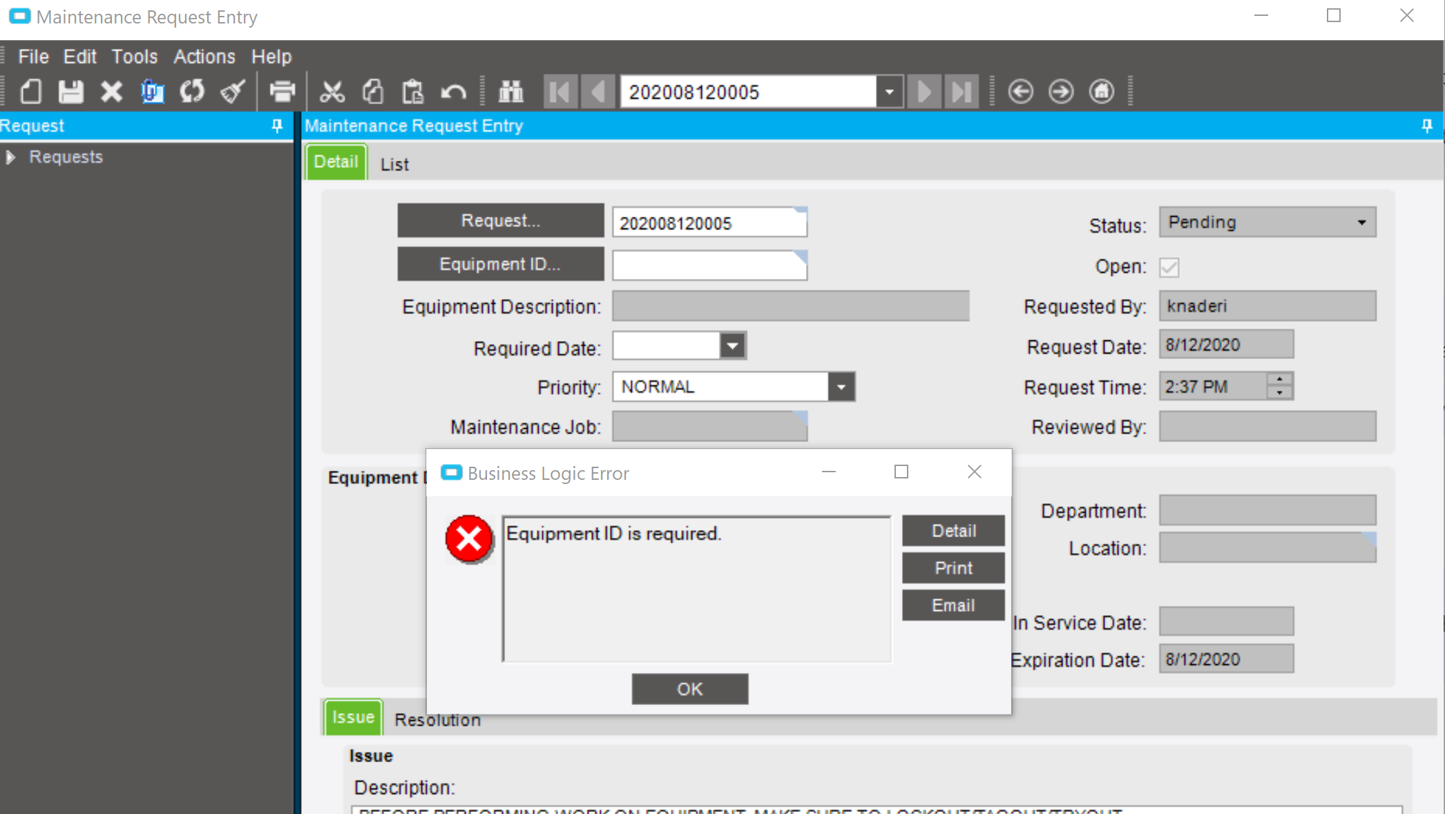

I also commented out every line of my code below oTrans.OnGetNew() and it looks like Epicor is still trying to save and clear the form even though oTrans.OnUpdate() is commented out.
It opens the form, creates a record, and then pops up the below message about a blank Equipment ID. The only time I’ve seen that message in testing is when I create a request and try to save it without selecting a piece of equipment.
