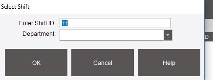

We are receiving this message the second time we clock in and the shift select menu comes up. It is customized with a combo box that retrieves from the Bo.JCDept to display departments.
I can’t figure out what the message is telling me. I tried to comment out all the code but that doesn’t help. It must be the object itself, but how do I avoid this?
Please see the photos attached.
This is the first time it is launched, it works fine:

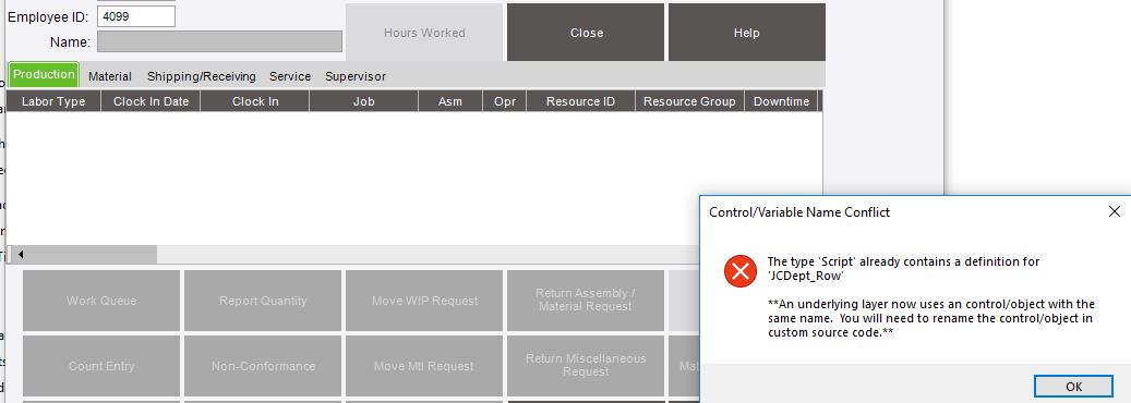

This is the second time it is launched:

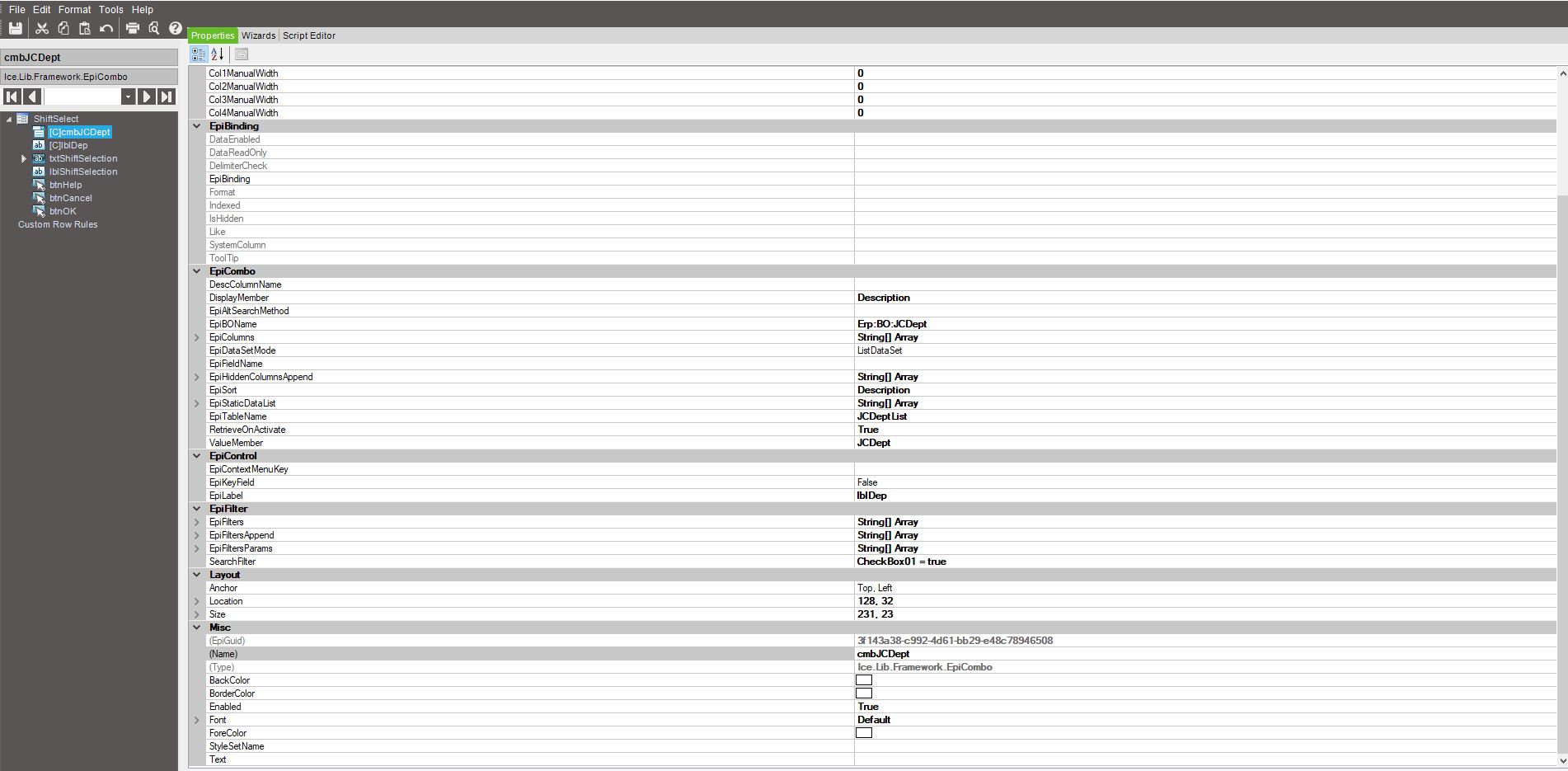

Can you paste your custom code and the properties page for your new combo box?
Right now I have no code and it still throws the error:
Here is the code:

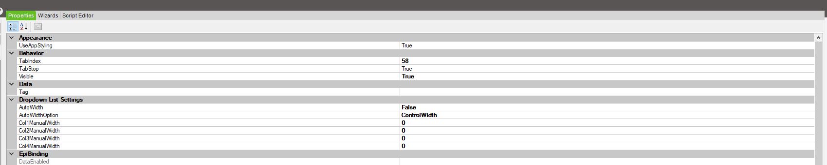

Here are the properties:
