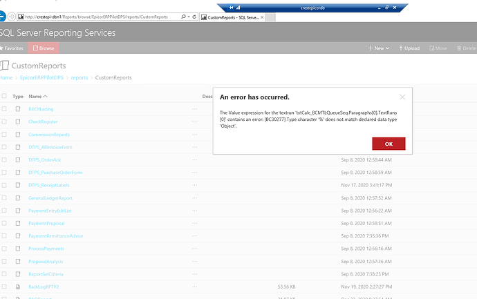

I want to add a tab into the MtlQueue SeqID field on the Material Queue Report so that when they scan the Process ID it auto-tabs to the next field. The %I works in SSRS report writer, but when I go to import the report Epicor Report Server I get the below error. I shouldn’t be getting two different results depending on where the .rdl file was created.
My field formula in Report Builder is =Fields!Calc_BCMTLQueueSeq.Value%I . Using the Code39 extended barcode.
You may want to try =Fields!Calc_BCMTLQueueSeq.Value & “%I”
It did not work. Although I am no longer getting the upload error, when I change the syntax to & “%I” the barcode becomes unreadable.
