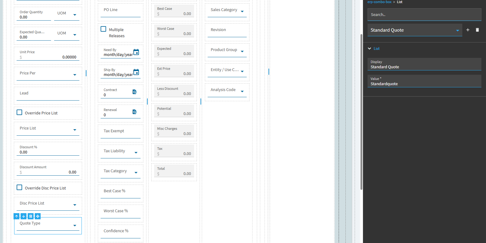

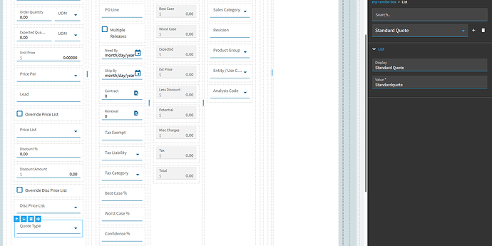

In the Layer, we have a Reusable Combo box with a custom Category List populated in the Advanced Settings:

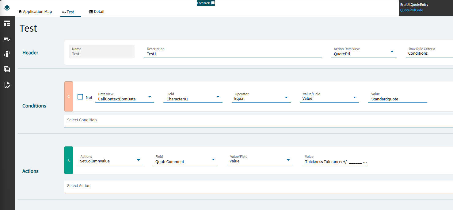

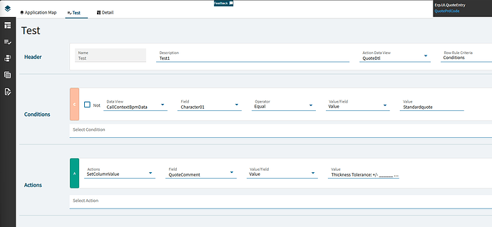

Then we have Data Rules that look for those Category values and has an Action to populate the Quote Comments:

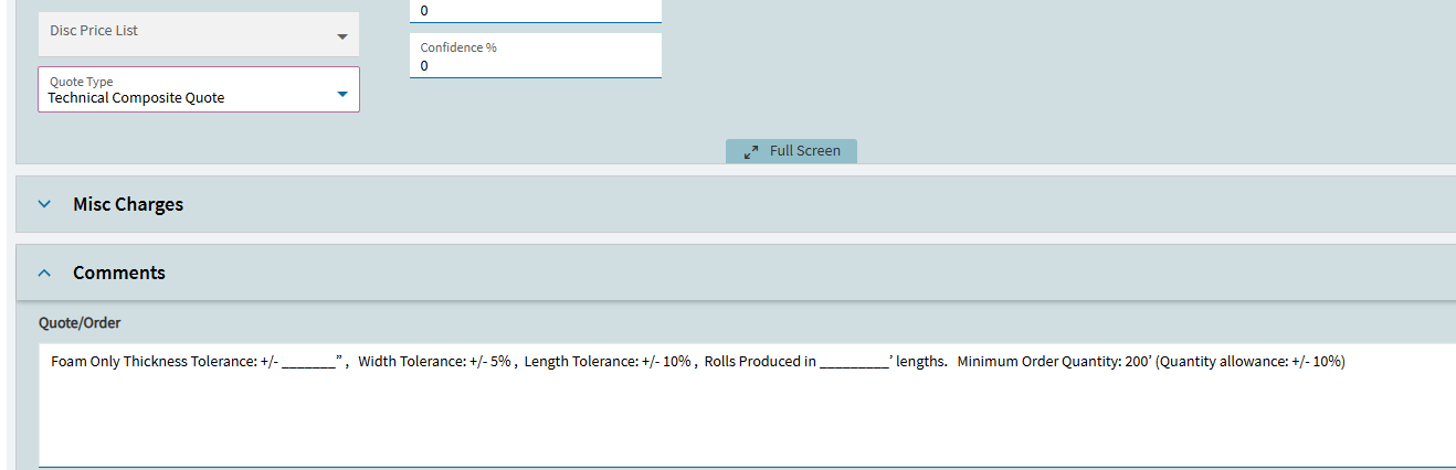

However, the textbox in Data Rules acts like a standard textbox and there is no way to format the text, even though it is storing the value in QuoteComment, which is a freeform text area on the Quote:
We want it formatting with hard returns, etc. Is there another way that we could go about accomplishing this using App Studio, possibly using Events and Actions?
