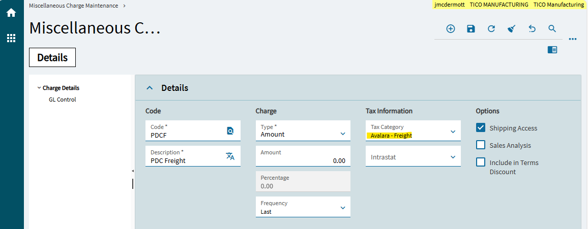

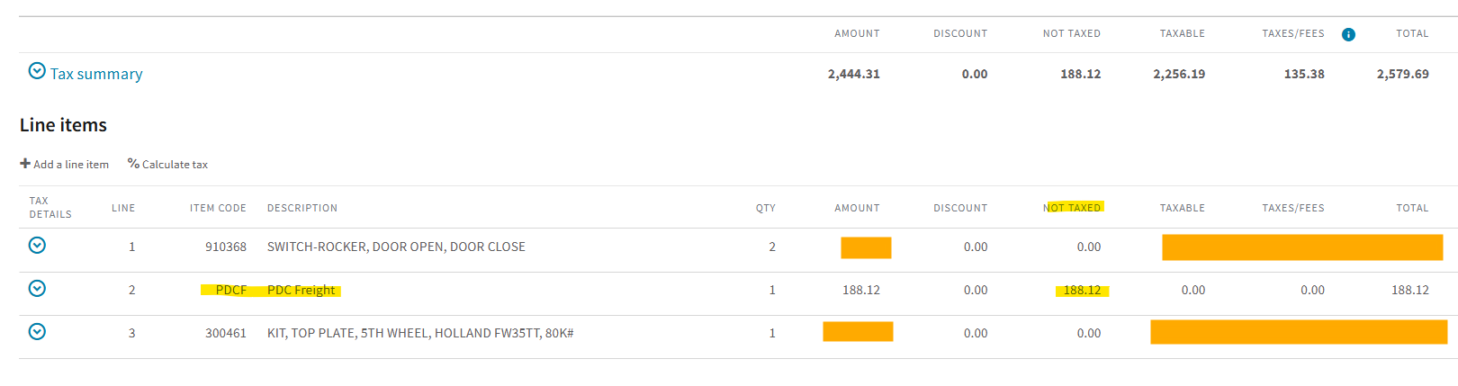

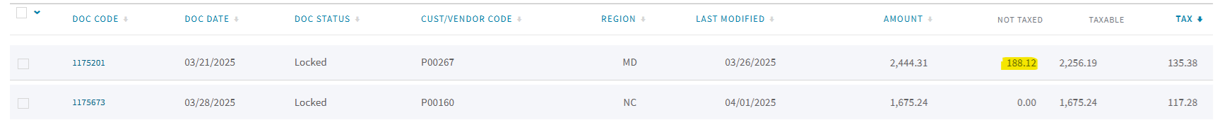

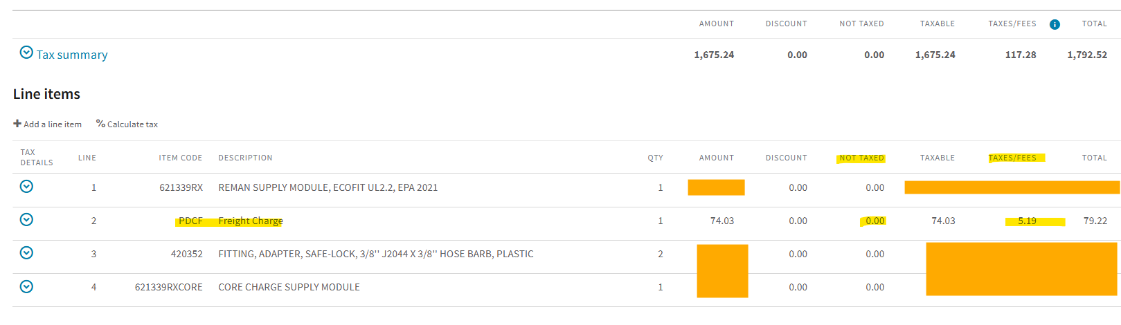

Here Maryland is exempting tax on freight and North Carolina is charging tax on freight. This aligns with Avalara’s public site, for example.
Here is the Maryland invoice, and freight misc charge is NOT taxed
And here is the North Carolina invoice, and freight misc. charge is taxed

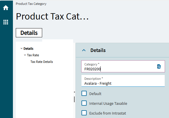

This works because of the setup of the charge and the corresponding “Tax Category” that uses a code from Avalara’s site (I’ll dig up the link if you want).

Right, that’s the idea. In Kinetic, misc. charges and product groups can tie to Tax Categories. The category needs to have the same ID as one you’d find here. You just do your best to find something that matches your scenario. Then Avalara deals with the laws regarding that scenario (like freight charges).
