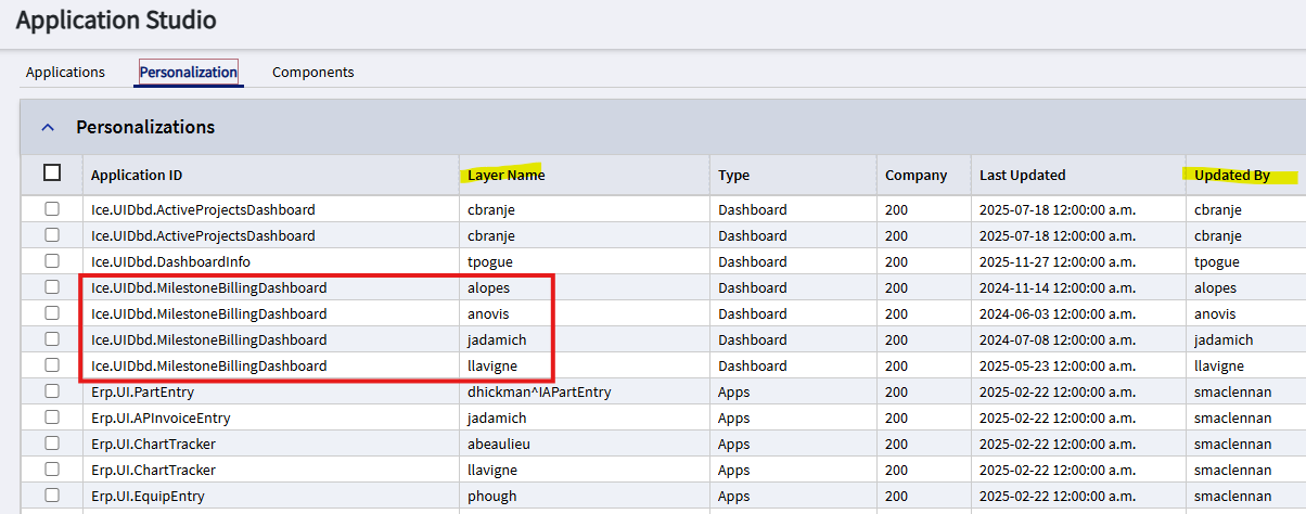

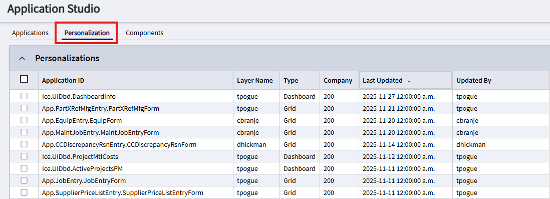

We have 2024.2 and when a user has a broken personalization it just comes up blank. We have an updatable dashboard to delete user personalizations but I just found out you can do it on the App Studio landing page in 2025.2. I don’t like this location because it’s easy to delete an application instead of a personalization if you’re not careful, but at least the option is there.
I believe it was added in 2025.1. (The silent thjng). The thing is app studio isn’t user specific which makes it useless.
I still want kinetic personlization purge to have bare minimum parity with classic.
The Layer Name and Updated By columns contain the user.
Oh wow does it actually work in 2025.2 then?
Yes it does :grinning_face:.

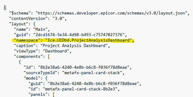

It exposed a bug for personalisations on a dashboard created using the based application wizard. Where the app name was always Ice.UIDbd.Template. This was fixed in 2025.2.6 for new personalisations.
I noticed that was the case for many of our apps. To ensure the personalizations are stored with the correct application name:
  1. Export the app
  2. Update the namespace in layout.jsonc in the ZIP file to indicate the actual app name
  3. Import the revised ZIP.
If you use our template and @mbayley’s Copy Application, it will update the namespace for you.
