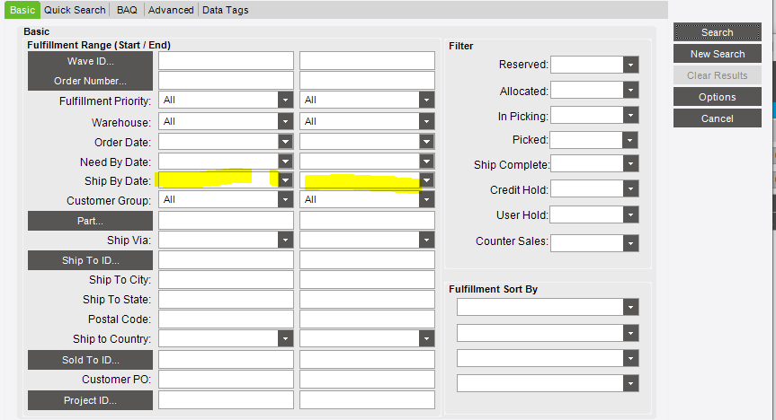

Ok lets start that the beginning. How do i come up with open orders to print to pick? like i want to print all open orders that have a ship date of today and tomorrow so i can see all those orders to chose from? Lets start slow thanks
OK - so the fulfillment workbench is a means of reserving and allocating stock in a methodical manner, based upon a set of search parameters.
If you want to look at orders with a ship date of today or tomorrow, you select the ‘Ship By Date’ in the order search.
This will give you a list of all orders that need to be shipped today or tomorrow.
What follows is the most straightforward of processes, but there are plenty of other parameters to determine the orders you want fulfilling.
You then select the orders you want to process, in the simplest of cases - press the ‘Select All’ button.
