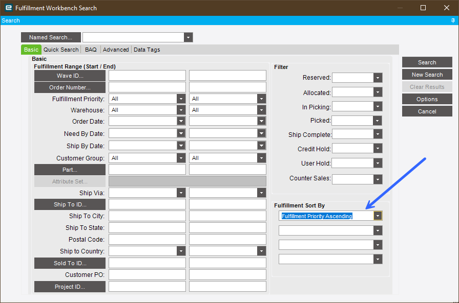

I see in fulfilment workbench there is a Fulfilment Sort by Priority but how do we set that?
I don’t know what priority is either, but if that doesn’t work I thought that this would be able to help with things like this, but again, I may be misunderstanding the fulfillment workbench.
You’re probably asking once it’s in fulfillment workbench how do you sort it by priority… so that functionality doesn’t solve that…

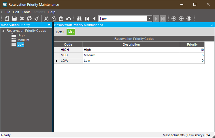

Found it!!
Reservation Priority Maintenance
Lets you create priorities

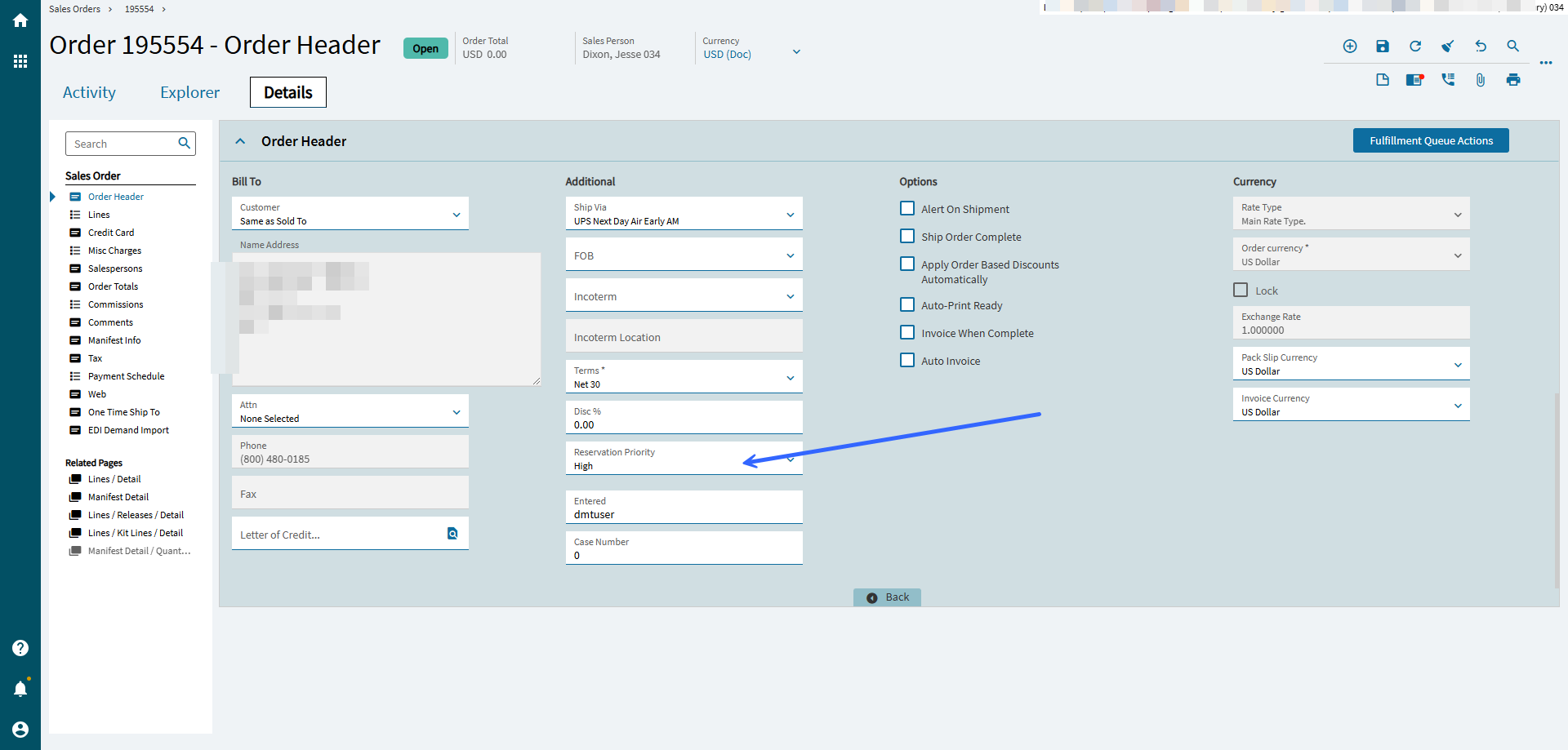

Then in the Sales Order (Order Hed) you can set the Reservation Priority then you can use that Sort in Fulfilment Workbench
Looks like it was recently added because its available in the Kinetic Screen(Order Entry)
