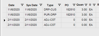

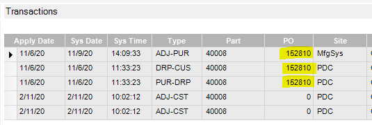

:question: PartTran stamps the ADJ-PUR record with a site (and site2) of MfgSys
It’s annoying because the ADJ-PUR transaction disappears in Part Tran History Tracker, since it’s not in the PDC site. (To boot, in this specific case the part does not even have a PartPlant record in MfgSys - which is fine by itself - but it means that I had no way to see the transactions except in a BAQ)
What flagged it was that it didn’t show on the Inv-WIP Report when I ran it for only the PDC site. It flexed to the right account (whew) but it sure confused me for a while.

Part Tran History:
BAQ:

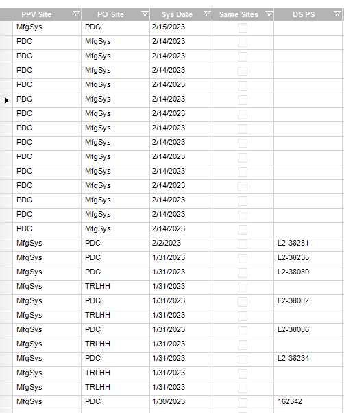

I did a BAQ today (in version 2021.2) and it looks the same. PPV goes to the site/plant that the AP person is logged into when creating the invoice (or posting it?).
I probably never reported this as a bug or anything.
I don’t know what you are asking about the report, though.
Also, back then I had said it was just for drop-ships, but I don’t know if I agree with that. It looks like this happens with any kind of PPV (ADJ-PUR). The last column below is the drop-ship pack slip and it’s blank on about half.
