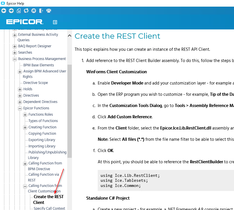

You can do this in client code without user names and passwords by using the RestClient helper that is built in to Epicor 10.2.700+ it uses your current session to make the calls.
Awesome, do you have an example of its usage documented somewhere?
Sure thing! Its in the Epicor Help

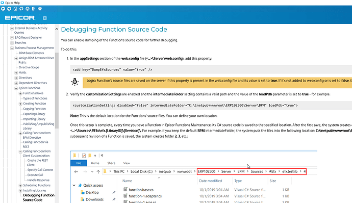

For BPM’s, you can see the history in the server->BPM folder. Where are the sources for these functions stored?
I wonder when this made it in, been asking for months in preview program meetings for a BO or something to be able to do this… Thanks!
This was released with 10.2.700.0
You can also see the Source Code of functions in a folder like you do BPMS. This is configurable in your sysconfig file (also in the Epicor Help)
Thank you. Your encyclopaedic knowledge continues to amaze me. Time to go back and re-RTFM.
haha yeah the FM has grown quite a bit… I’m having to do a lot of reading too
–Cheers
Be warned the scaffolding code they use heavily sandboxes the code and isn’t easy to read for debugging purposes, but it’s an ok solution if you just want a backup of your own code…
You’re right, but it’s better than nothing. Would also mean the issue of recreating a function from scratch is somewhat nullified. Especially if you’re using a code widget with your own code, it will be there verbatim.
