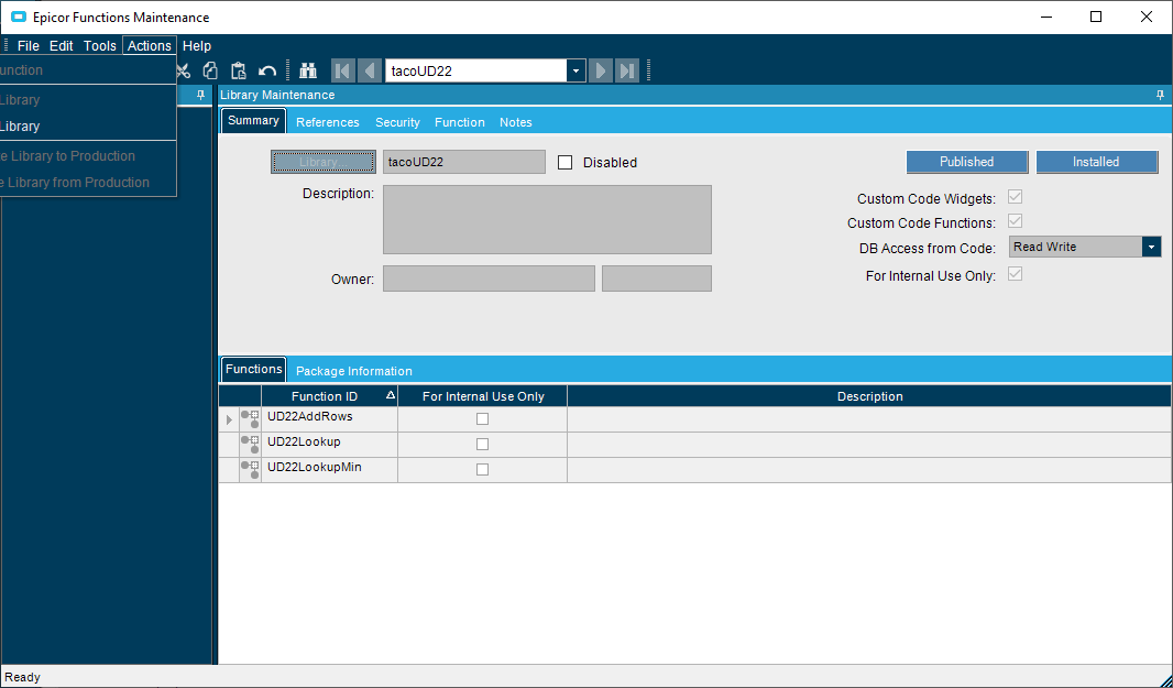

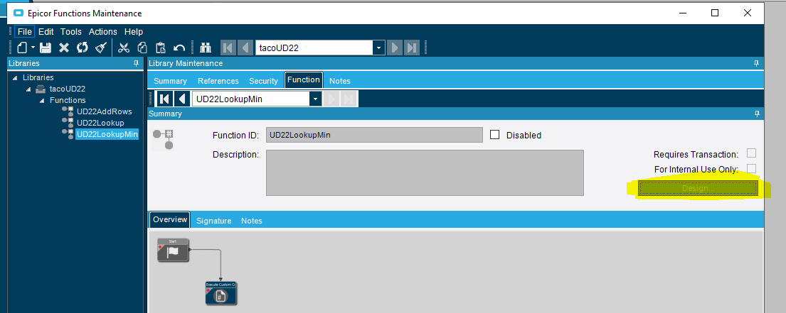

I bring in the solution that holds the ‘func library’, however that Library is completely read-only- I cannot even get into th workflow in order to recreate them:
The only thing available from the ‘Actions’ menu is ‘Import’.

Cannot demote it, only thing available form the Actions menu is ‘Import’:

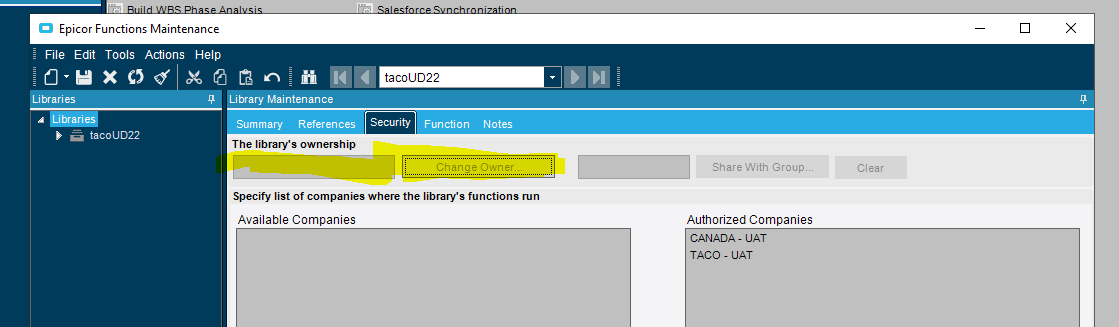

Do you have to change the owner?
Brandon:
That is also disabled, and it shows ‘no owner’:

I just find it hard to believe that we can’t even recreate the code unless from scratch-the workflow is unavailable.

Success- thanks again Jose - there were a couple of other columns to ‘tweak’ in order to free up the functions ‘design’ button: ‘Published’, ‘Private’ both false
