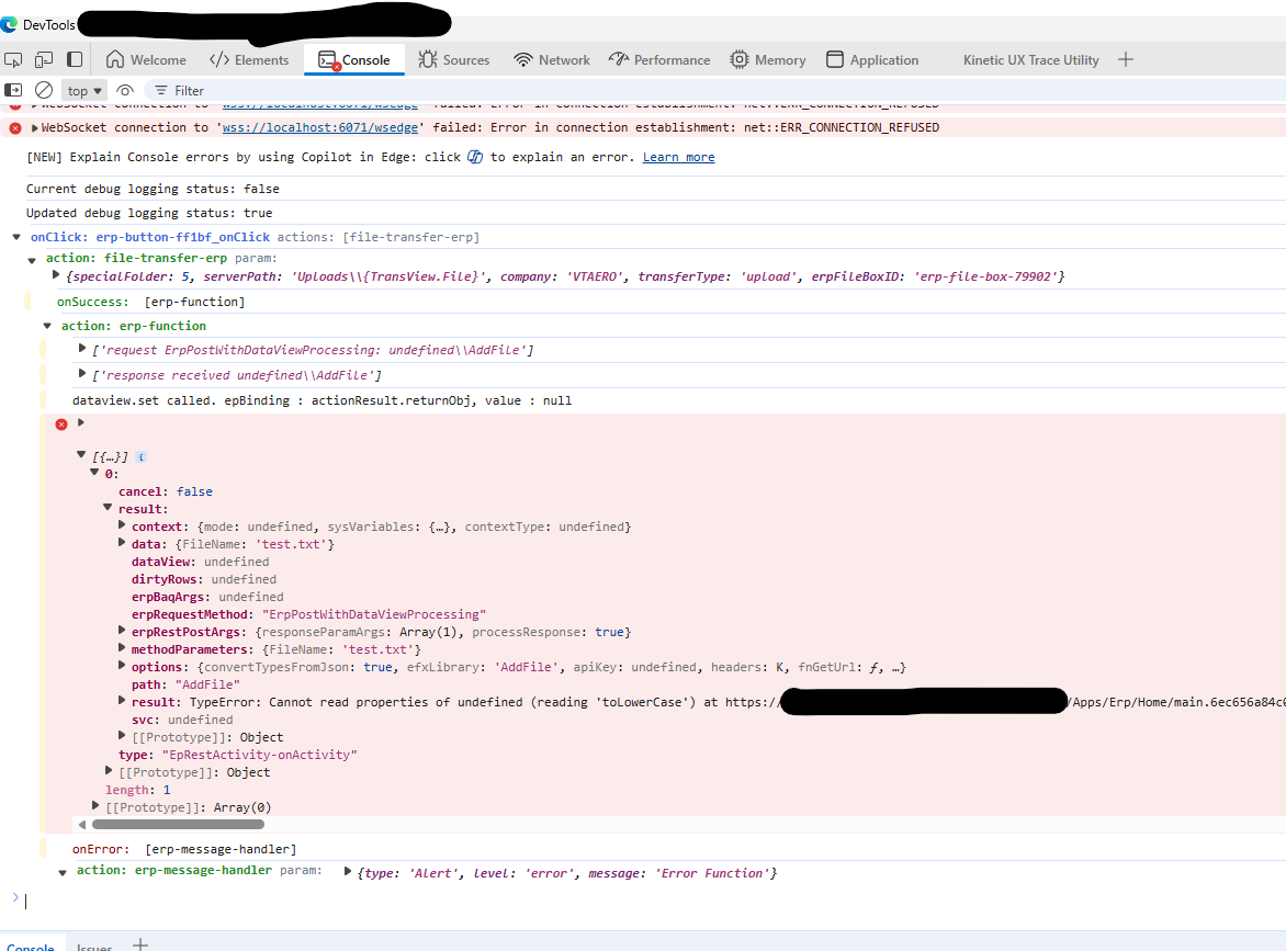

I am using the solution from here: Add File to Line Comments in PO Entry - Kinetic ERP - Epicor User Help Forum to add a file to a comment field. I am using this function in several places. However today, I am trying to add it to the Sales Order Comments, on the first field OrderHed.OrderComment.

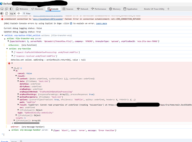

I am getting Error Function on my Event. In Dev Tools I can see this:
Noting the toLower error.

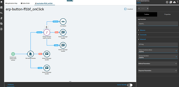

Here is my event as laid out in Sales Order Entry: (Note: I use the same layout for my event in Job and PO Entry. It work well in those places.)

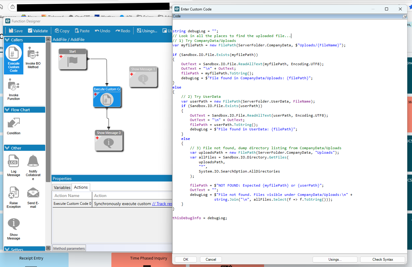

Here are the innards of the function:
This same exact function works perfectly on other forms (Job Entry, PO Entry). Is there something special about Order Entry that is preventing this from working?

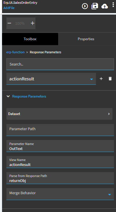

The solution was to recreate my function widget in the event. From post 13:
If you ever click Dataset, you just ruined that widget. Delete it and start over.
Ugghh. Why… just why?
