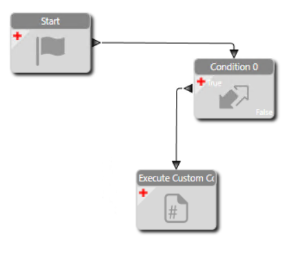

My advice is to limit your BPMs to 2 types of widgets
  1. condition
  2. custom code
That’s all you need. Follow this pattern
I agree with @klincecum on the best practices.
For functions, go for code only. Easier to troubleshoot without having to un-promote it. If you do not know how to do something, dump the code of a widget.
And they break when Epicor decides to change the definition of how many input parameters go into a method.
Pro tip: if you highlight a bunch of widgets at once, you can rename them in a hurry in the grid at the bottom of the screen.
I mean, literally all you need is the custom code widget. I’m not really gleaning the wisdom here.
You can. Has it changed?
Good that you point that out Jason, I hesitated to give a reason, but now that you mention it. I always end up adding those same conditions within the custom code, otherwise it would seem incomplete, but to have a separate widget with conditions is helpful for other people trying to figure it out what criteria the custom codes needs without looking at the code (which can be quite intimidating sometimes).
Why would you do this lol :sob:
foreach is so simple
That condition widget is damn handy, got some good baked in stuff in it.
