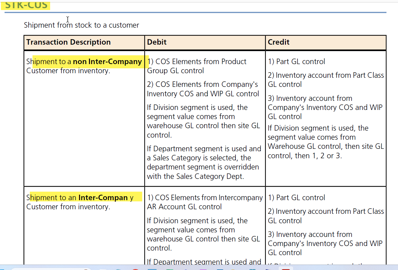

It appears the inter-company does affect GL posting for STK/MFG-CUS transactions:
