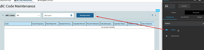

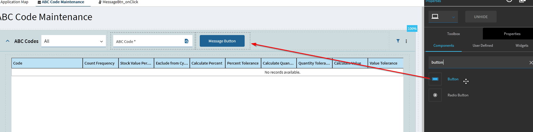

Then went to ABC code and made my layer. Added a button to the layer so that I could get an event.

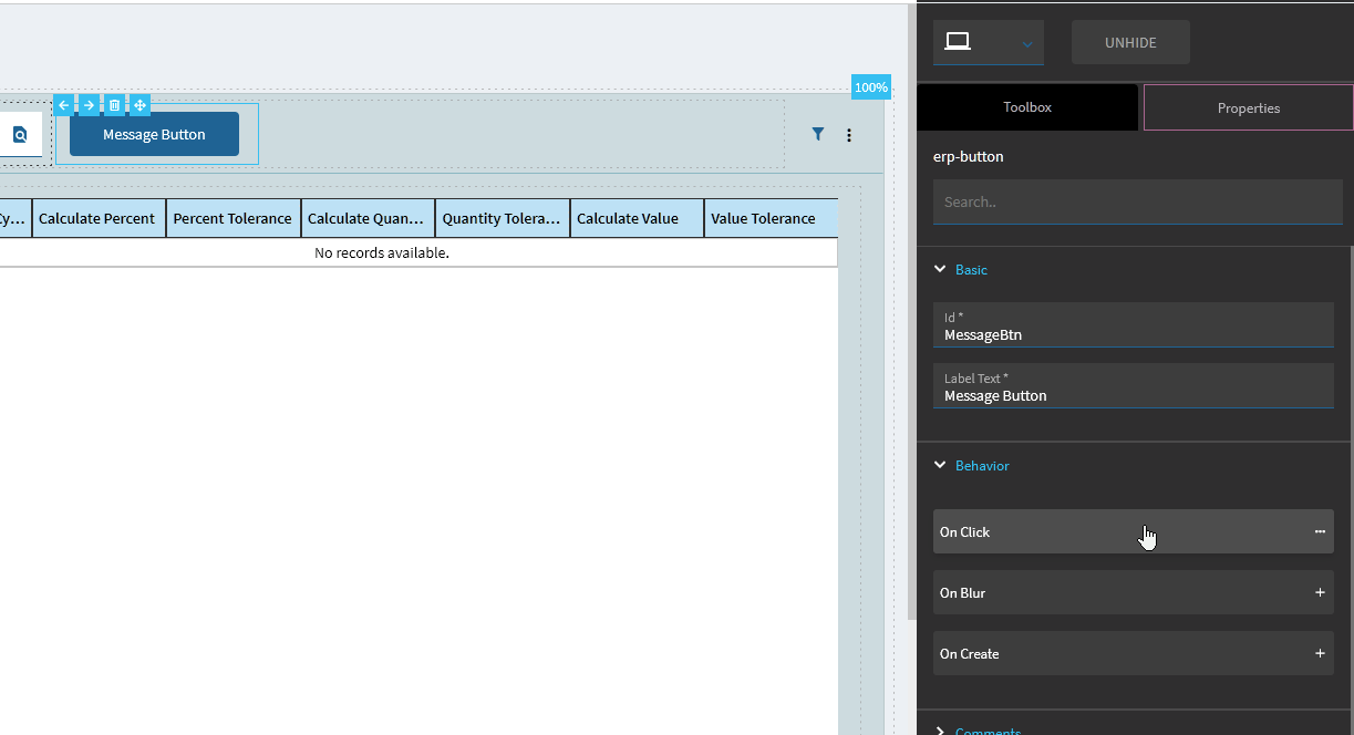

On the behavior of the button, you click on the event you want to go to, then it opens the button click event.

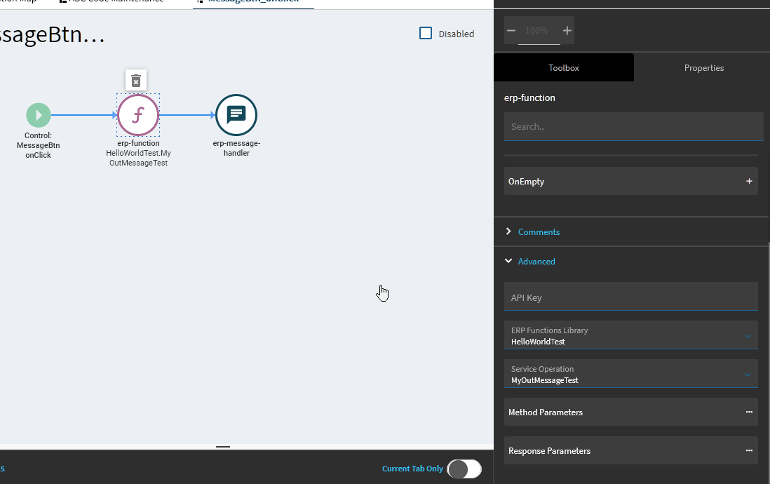

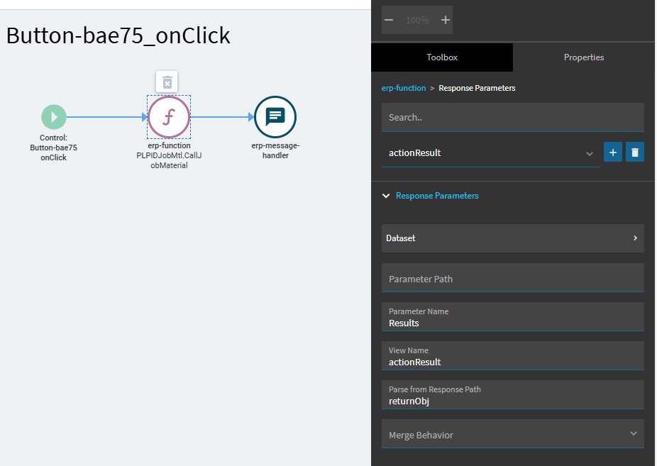

Drag an ERP-Function widget
In the properties, select your library and “Service operation” (apparently this isn’t consistent throughout the application. I would call it a method, but who am I)
For this simple of a function, that should be all that you need to do. For more complicated stuff, you’ll need to assign to datasets and stuff, but that’s beyond my expertise (I use that phrase lightly) level.

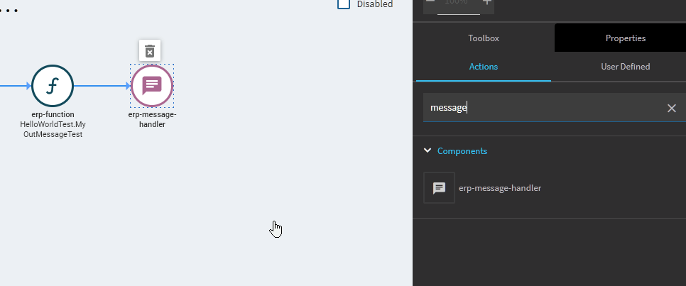

Then grab the message widget.

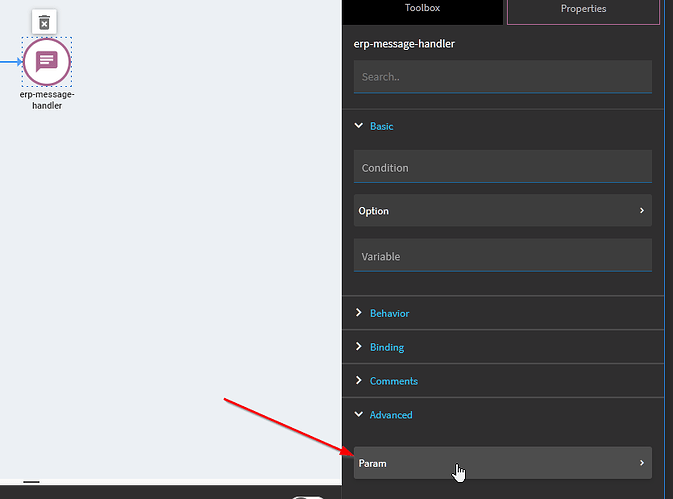

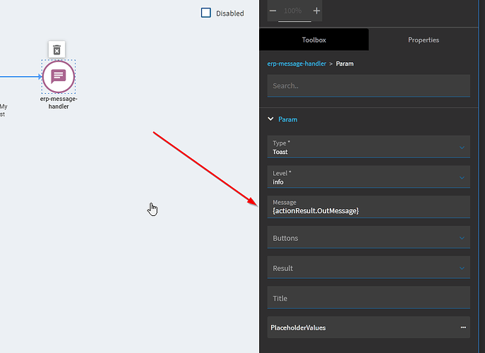

Go to “Advaced” “Param”

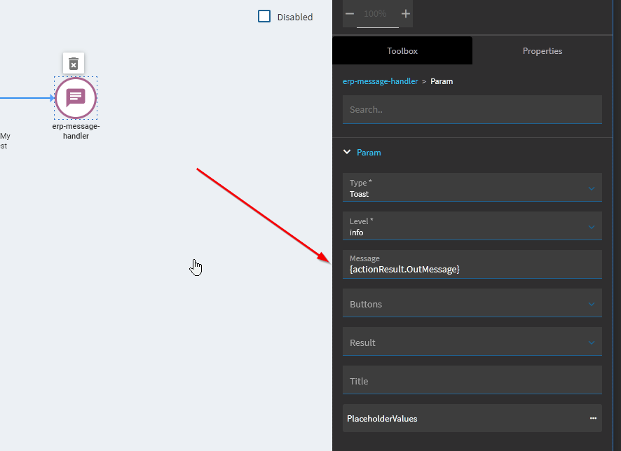

Here you set the type of message you want, the level, and finally, to my favorite… Magic string. {actionResult.yourResponseParam}

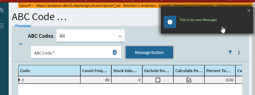

Now preview, and click the button, and a message popup, with my lame message.
Now, there are tons of caveats that @hmwillett started telling me that will come into play as you get into more complicated/realistic scenarios, but this is how you can pull a result from a function into a popup message.

@hmwillett , can you explain the “Magic String” some more? Is it an object that can be referenced in multiple places?
St Patricks Day Rainbow GIF by TipsyElves.com
It’s only “magic” in the sense that much like any other programming language, it has its own syntax.
The curly braces tell App Studio to use the value within the DataView.Column. Without the curly braces, you’re sending it a literal.
For example:
DataView Column
TransView FirstName
Let’s assume you assign TransView.FirstName to be Hannah.
Doing: {TransView.FirstName} will output Hannah as the value.
Doing: TransView.FirstName will output the literal string TransView.FirstName as the value.
It’s pretty much just string interpolation.
To add to what Hannah explained above, actionResult is a system DataView that stores the results of a function call. The next time you called a function, the contents of the actionResult DataView would be replaced.
