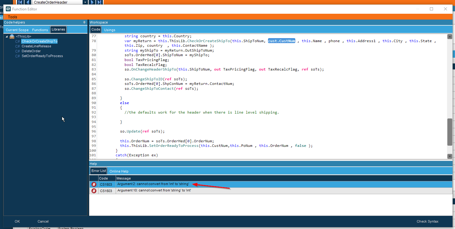

Does anyone know how to fix this? If you mess with the signatures in the functions, the syntax checker can throw up false errors. Sometimes they will go away with recycling, but this one has been stuck even after moving the functions from environment to environment. It still saves and works fine, but there errors in the error list are super annoying.

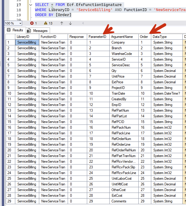

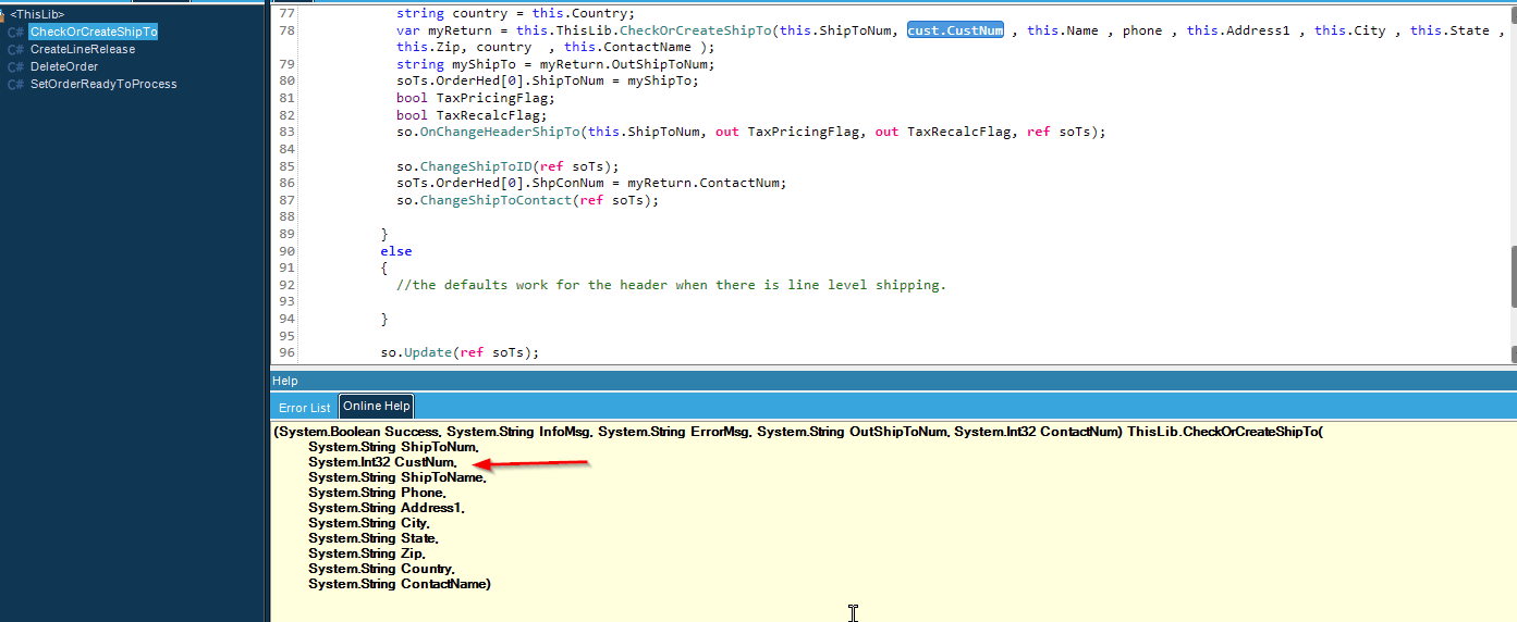

So whatever is looking at the signature for the syntax check isnāt looking at the same thing as the one on save. This is a screen shot after I fixed it, but if you move things around, the ParameterID and Order arenāt the same number, which is understandable. However, the syntax check was getting the field order from the parameterID instead of the order, so it was giving you an error, when it doesnāt really have one since the compiler uses the order (like it should). So I adjusted the parameter IDs to match the order number, and now the error goes away.
