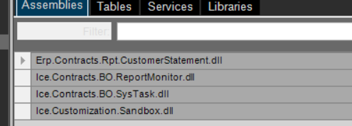

Yes, you will want to switch to RunDirect, and then just grab the bytes, and push them.
Let me dig up one of my examples.
byte[] reportPDF = null;
string taskNote = Guid.NewGuid().ToString(); //Magic
CallService<Erp.Contracts.CustomerStatementSvcContract>(custStatSvc =>
    var ds = custStatSvc.GetNewParameters();
     var paramRow = ds.CustomerStatementParam[0]; // Row 0 is parameters, Row 1 is Report Style parameters
     paramRow.EndDate = DateTime.Now;  // Default today
     paramRow.BeginDate = DateTime.Now.AddDays(-30);  // Default 30 days ago
     paramRow.AgentID = "System Task Agent";
     paramRow.ReportStyleNum = 1001;
     paramRow.AutoAction = "SSRSGENERATE";
     paramRow.TaskNote = taskNote;
     paramRow.SSRSRenderFormat = "Excel";
     custStatSvc.RunDirect(ds);
long sysTaskNum = 0;
CallService<Ice.Contracts.SysTaskSvcContract>( st =>
    sysTaskNum = st.GetList( $"TaskNote = '{taskNote}'", 0, 0, out _ ).SysTaskList.FirstOrDefault().SysTaskNum;
CallService<Ice.Contracts.ReportMonitorSvcContract>( rm =>
    var rptSysRowID = rm.GetList( $"SysTaskNum = {sysTaskNum}", 0, 0, out _ ).SysRptLstList.FirstOrDefault().SysRowID;
    reportPDF = rm.GetReportBytes(rptSysRowID);
if(reportPDF != null)
    var sb = (ISandbox)Sandbox; //Makes autocomplete behave
    var fp = new FilePath(ServerFolder.FileShare, "SomeFileNameYouDoYou.xlsx");
    sb.IO.File.WriteAllBytes(fp, reportPDF);
Probably not exactly right, but should get you started. Coding here in the editor lol.
Thank you so much, I was able to work with it
//P0001 - Setup function
using (var context = Ice.Services.ContextFactory.CreateContext<ErpContext>())
    var custStatSvc = Ice.Assemblies.ServiceRenderer.GetService<Erp.Contracts.CustomerStatementSvcContract>(context);
     var paramRow = ds.CustomerStatementParam[0]; // ParamRow.BeginDate
     paramRow.EndDate = DateTime.Now;  // Default last day previous month
     paramRow.BeginDate = DateTime.Now.AddDays(-30);  // Default first day last month
     paramRow.AutoAction = "SSRSGENERATE";//  "SSRSPrint"; // "SSRSGenerate"; // "SSRSPreview";    // Generate or Print - Preview opens Excel, Print forces PDF
      string userID = callContextClient.CurrentUserId;
      paramRow.WorkstationID = "web_" + userID;
      custStatSvc.RunDirect(ds);  // Generate the report
      // Get the task number
      // Get the report
      string filename = DateTime.Now.ToString("yyyy-MM-dd") + " CustSt " + ((DateTime)paramRow.BeginDate).ToString("yyyy-MM-dd") + "_to_" +  ((DateTime)paramRow.EndDate).ToString("yyyy-MM-dd") + ".xlsx";
      // Add subfolder
      filename = "Daily/" + filename;
          var fp = new FilePath(ServerFolder.FileShare   ,filename);
Edited to preformat text and to add a subfolder.
