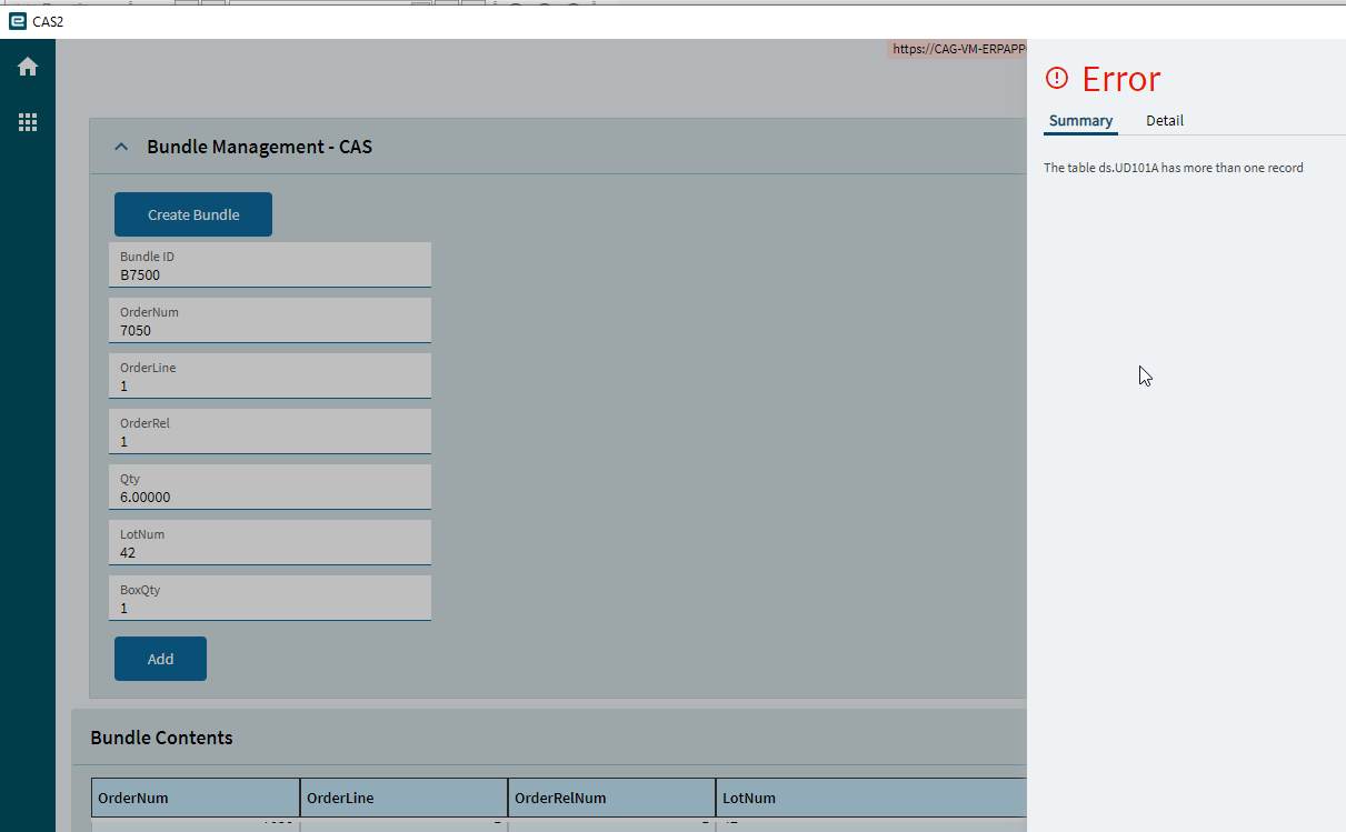

If UD child table has no records the following code works fine:
this.CallService<Ice.Contracts.UD101SvcContract>(svcUD101 => {
    var tsUD101 = svcUD101.GetByID(BundleID,"","","","");
    svcUD101.GetaNewUD101A (ref tsUD101, BundleID, "", "", "", "");
    var UD101ANew = tsUD101.UD101A.Where(r=>r.Added()).FirstOrDefault();
    UD101ANew["Company"] = Session.CompanyID;;
    UD101ANew["Key1"] = BundleID;
    UD101ANew["Key2"] = String.Empty;
    UD101ANew["Key3"] = String.Empty;
    UD101ANew["Key4"] = String.Empty;
    UD101ANew["Key5"] = String.Empty;
    UD101ANew["OrderNum_c"] = OrderNum;
    UD101ANew["OrderLine_c"] = OrderLine;
    UD101ANew["OrderRelNum_c"] = OrderRel;
    UD101ANew["Quantity_c"] = Qty;
    UD101ANew["Character01"] = LotNum;
    UD101ANew["Character02"] = "WCAS";
    UD101ANew["Character03"] = "RECEIPTBIN";
    //UD101ANew["RowMod"] = "A";
    svcUD101.Update (ref tsUD101);
If more than one record exists it still adds the line but I get:
Any ideas?

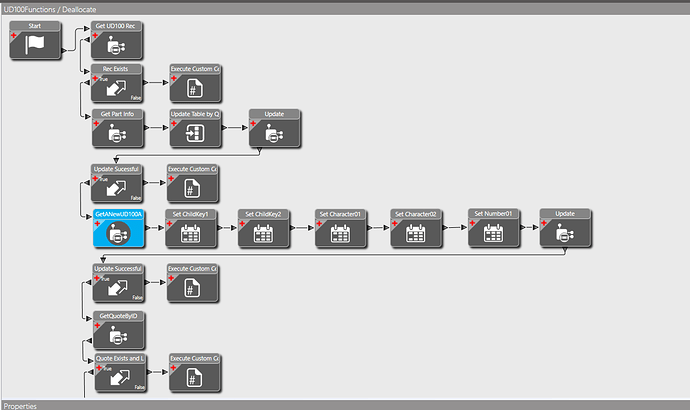

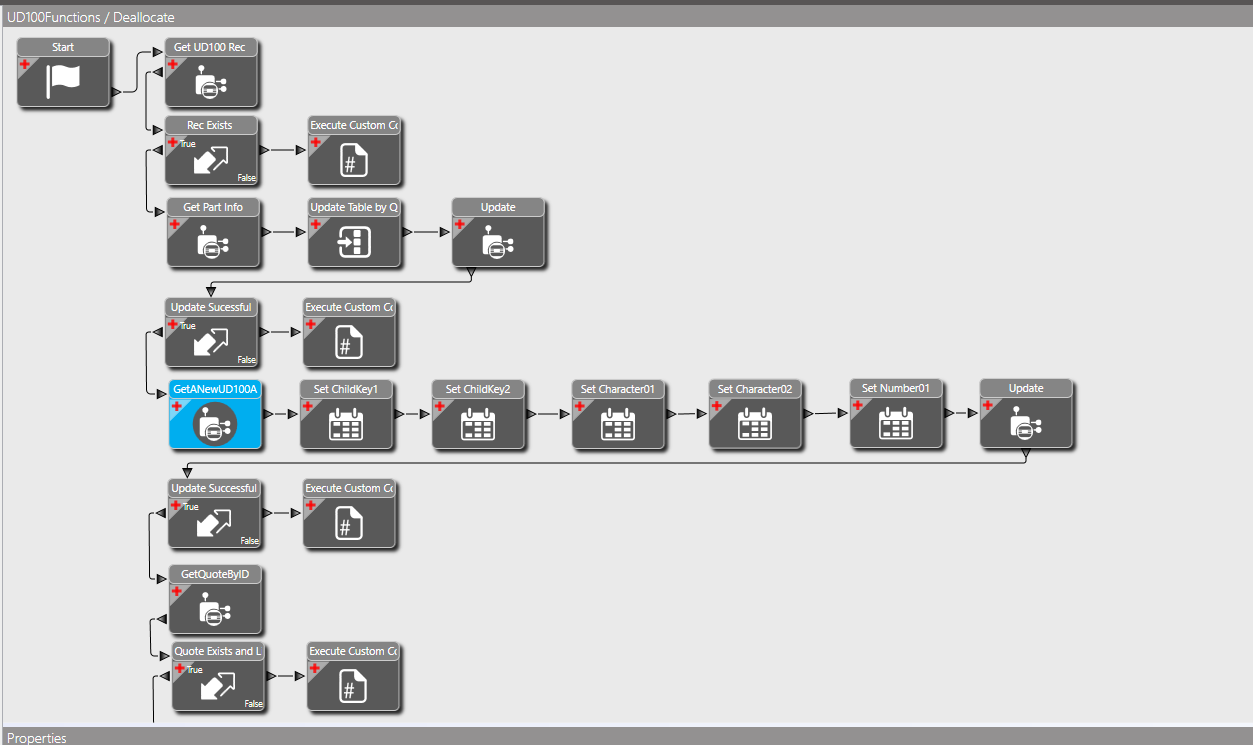

You could make your life easier and do it with widgets :slight_smile:
I’ll give that a whirl - I guess I’m a little old fashioned :slightly_smiling_face:
