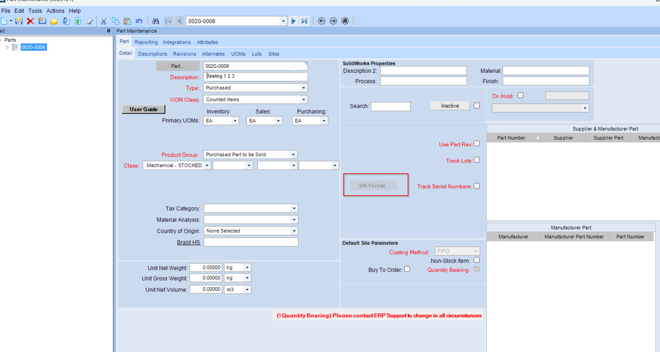

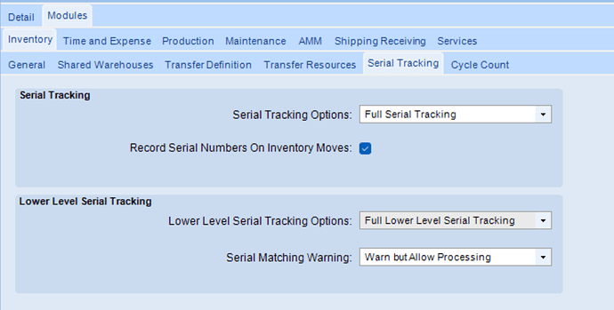

Yep serial tracking is on at the Site. I can also check the track serial check box in the part entry screen so I assume the setup of every thing is good.

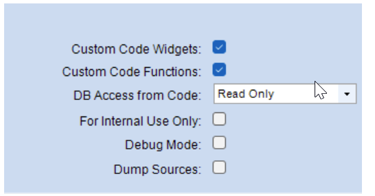

If you were going to just attempting to update the flag and forget about any special processing that is done by the BO then you would add the table as a reference, set it to updatable and then use the Db.SaveChanges();

The code you posted the first time works perfectly for me. But I had to go in and set a serial mask/format for the part first. I did that in Part entry. I think that’s the piece you’re missing.
