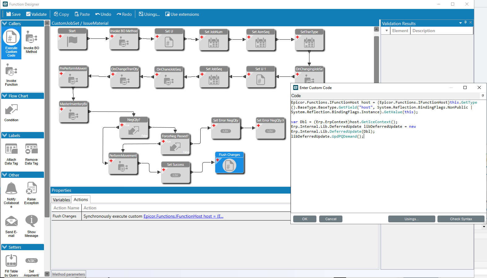

I tried placing the following code snippet
var context = Ice.Services.ContextFactory.CreateContext<ErpContext>();
Erp.Internal.Lib.DeferredUpdate libDeferredUpdate = new Erp.Internal.Lib.DeferredUpdate(context);
libDeferredUpdate.UpdPQDemand();
in a custom code block after my final call to Erp.IssueReturn.PerformMaterialMovement and then called the function via my REST client and receive the following error:

We have (and do) use it successfully in Functions. Though we reflected the Db object instead of usig context
Epicor.Functions.IFunctionHost host = (Epicor.Functions.IFunctionHost)this.GetType().BaseType.BaseType.GetField("host", BindingFlags.NonPublic | BindingFlags.Instance).GetValue(this);
var Dbl = (Erp.ErpContext)host.GetIceContext();
Erp.Internal.Lib.DeferredUpdate libDeferredUpdate = new Erp.Internal.Lib.DeferredUpdate(Dbl);
Well, I’m not getting that error anymore, but my on hand quantity isn’t reflecting the change again. The PartTran table does appear to be getting updated since the Previously Issued field on the Issue Material screen does show the correct value.
So, similar to the response from @mikelyndersOKCC in the Automating Fulfillment Workbench Via Epicor Function - #4 by adaniell link you reference, I just needed a bit of patience for the previously deferred entries to make their way out. Calls to my function now result in the on hand quantity immediately reducing.
This potentially explains other instances with similarly odd behavior. I’m sure this isn’t a panacea, but hopefully another arrow in the quiver! Thanks for your help! Epiusers is truly one of the best things about Epicor :slight_smile:
