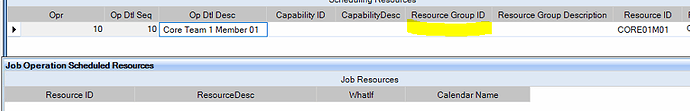

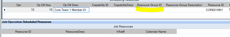

Below is the JobOpDtl for the CORE01M01 that has no RG, but the LaborDtl record ends up with one. I ran these w/o my bpms to be sure I was not ā€œfixingā€ this issue all along.
No RG
When I start activity something fills in the RG from the resource.
