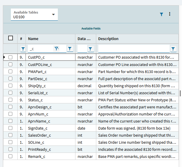

Another thing I do, since you have to use the UD table key fields, is to update their label in Extended Properties, so that at the very least when I use that field in a BAQ or add it to something, it will come across with a label different than the generic Key1, etc.
so funny thing about that. When you are looking at the list of fields in the baq designer, before you select anything, the labels are not there. But then once you move a field to the selected list, the label shows up. Irritating but I don’t have the motivation to log a ticket about it. I just move all to the right side to see the labels and then remove what I don’t want.
Another thing I now always do is even if I’m not creating any UD fields in one of the Ice.UDxx tables specifically, I still go to UD Column Maintenance and create the table - then in the description capture what it is used for. Be kind to your future self, document it - and go back and document the ones that have been used in the past and the legacy Excel sheet isn’t up to date!
You can query the Ice.BpDirective table, Ice.QueryHdr table etc for any references to UD01, UD02 etc to try and gain some understanding of what it might be used for.
Well, yeah, there isn’t a label column on the select side, for any field.
I failed to mention that I also will input a Description in Extended Properties/UD Column Maintenance. Those do show up in the selection list.
