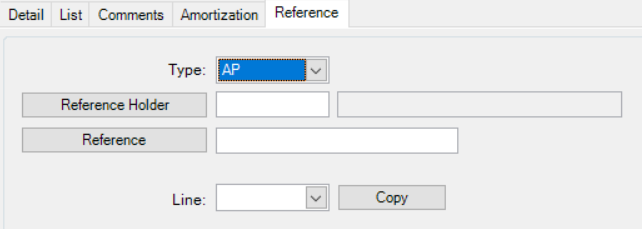

General Ledger Import link to supplier?
Using the General Ledger Import function, is there a way to automatically link to a supplier?
(Financial Management > General Ledger> General Operations > General Ledger Import)
The General Ledger template caters for Journal Detail Comments, but not reference?
edited to add: This is from GL Journal Entry, which has the option for reference.
We are going to be using 3rd party provider in regards to credit card transactions - card users will be allocating their expenditure on this app, which will generate the GL codes to be imported - this will save data entry time for the finance team.
The credit card holder will be selecting the supplier on this app and I need to working out how to automatically bring this information into Epicor, otherwise the finance team will need to manually select the supplier for each transaction, before posting.

The screenshot is from the GL journal Entry Screen, I have edited my OP to say that.
