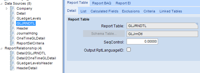

You need to add a new Data Source to your RDD. “New”… “New Table”.
Search for and add the GLJrnDtl table.
Quick tip… I always rename my added tables in ALL CAPS, so they stand out in the tree view. If I ever revisit this RDD in the future, I instantly know I added that table.
Next, review the “exclusions” under the GLJRNDTL table you just added. You’ll want to uncheck the fields you want to add. Need to at least include (uncheck):

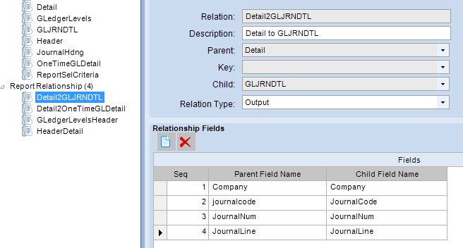

Next, go to “New”… and select “New Relationship”.
We’re going to link GLJrnDtl to Epicor’s generic “Detail” data source. Below are the relationship fields I used. Take note that Epicor’s Detail table uses all lower-case letters in “journalcode”.
That should be it for the RDD.
