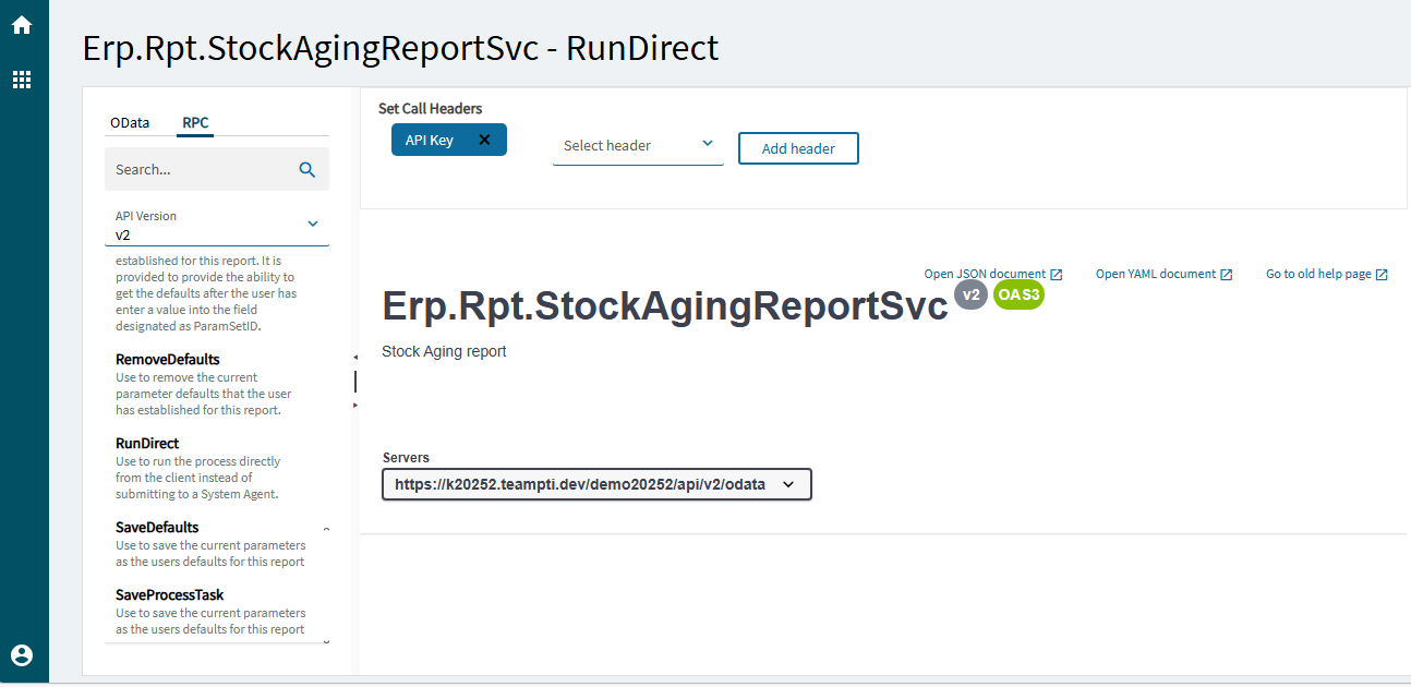

If you have to do a report, you don’t have to go through the System Agent. Each report has a RunDirect method.

Thanks, Mark. I have tried RunDirect earlier, but I can’t seem to get the payload right. I tried copying & pasting the payload from SubmitToAgent in the UI, and when I make the call in my program, it takes a few seconds to execute but returns empty JSON, just like SubmitToAgent does. Then when I log into the UI, I see the task as completed in my system monitor but it won’t let me download it as if my call got corrupted along the way.

If I could use RunDirect to just return the raw bytes, I would totally do that. I have tried it several times on different projects and I have not been able to get it right and I feel like I waste time. I also tried it with functions, but I only got as far as getting the task to show up in my notifications and my code IDE locking up.

Submit to agent hands the report processing off to the system agent to process and releases the thread back to the client. If using this you then need to poll for the systask / report to be completed before running get report bytes.
Run direct runs the report straight away in the current thread. This still returns a blank response however when you do get the response, which may take time / time out, then you know the process has finished and can call get report bytes straight away.
I thought this was the case as well, so I called RunDirect with the payload in the UI, then called SysMonitorSvc/GetReports and grabbed my latest SysRowID and passed that into GetReportBytes and it did not return my CSV.
