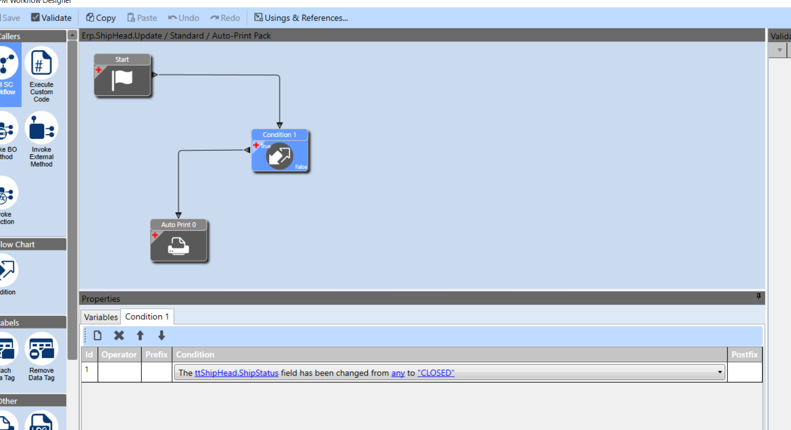

When we close a pack Id in classic version, it generates a pack id report which is triggered by Data directive.
But when I am closing a pack Id report in Kinetic version, it not triggering a report.
Is there a way to auto generate ssrs report in application studio.

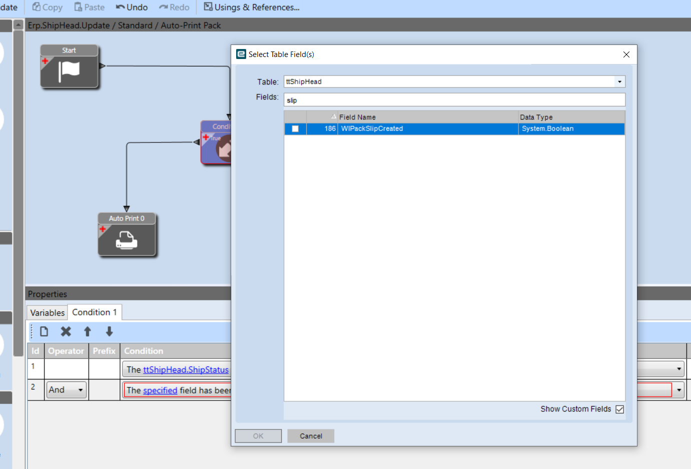

Try adding an ‘or’ - SlipStatus = "CLOSED"
Must be an on screen column then…
Data Directives and Method Directives should work as normal regardless of what UI being used.

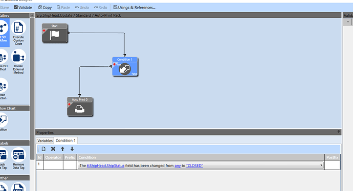

Doesn’t ttShipHead.Status has to be present in Data view application studio as well?
It is…

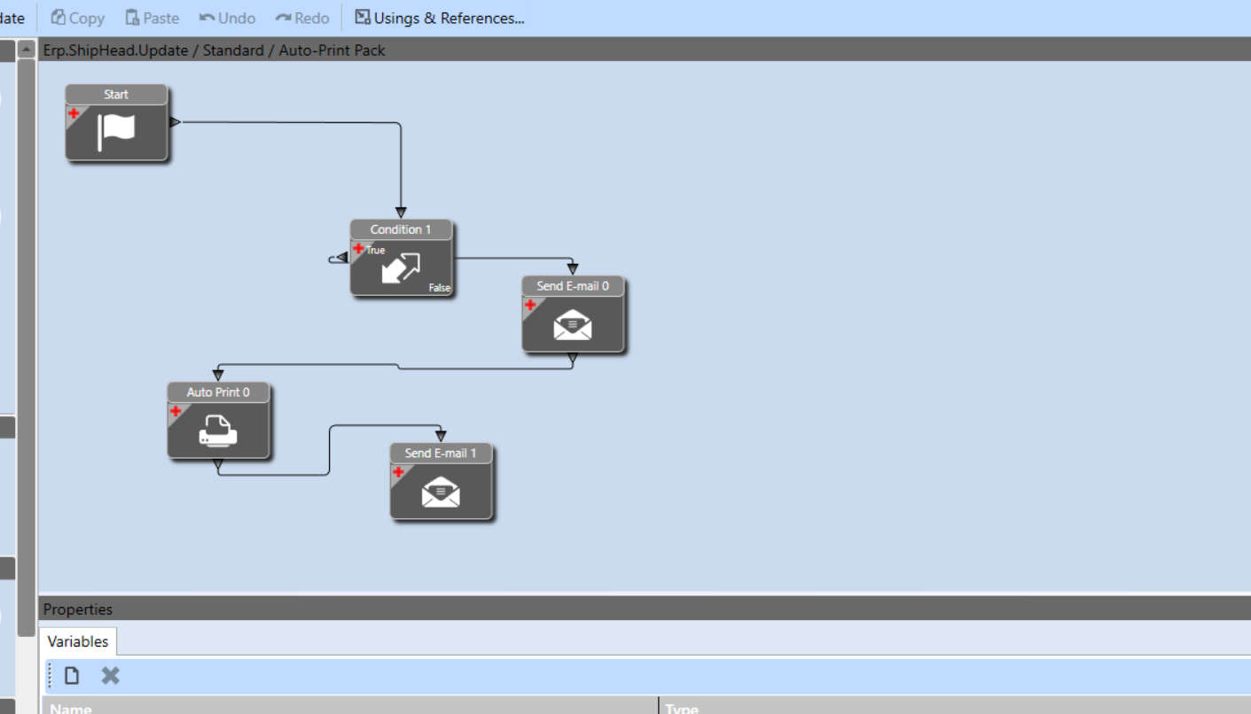

Another way of figuring out what’s going on…
Add a message box or get it to email you just before it does the printing with something like
JUST ABOUT TO START PRINTING
after print…
PRINT COMPLETE
PackNum: #22232
@aarong

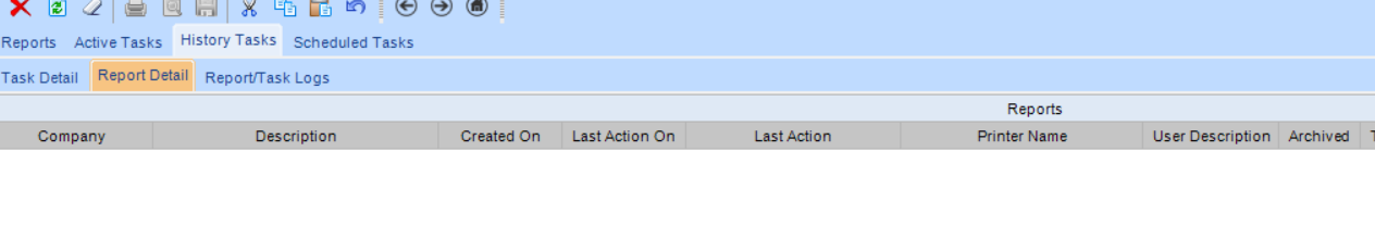

So I created an email after condition and after print and I got the mail from both interfaces but no report from Kinetic.
The report detail appears blank for it.

Because the Data directive is triggering from both interfaces.
I created a criteria for mail and I got those mails from both interfaces.
Yes, gotta follow the chain for method directives.
The data directive however should be the same.
