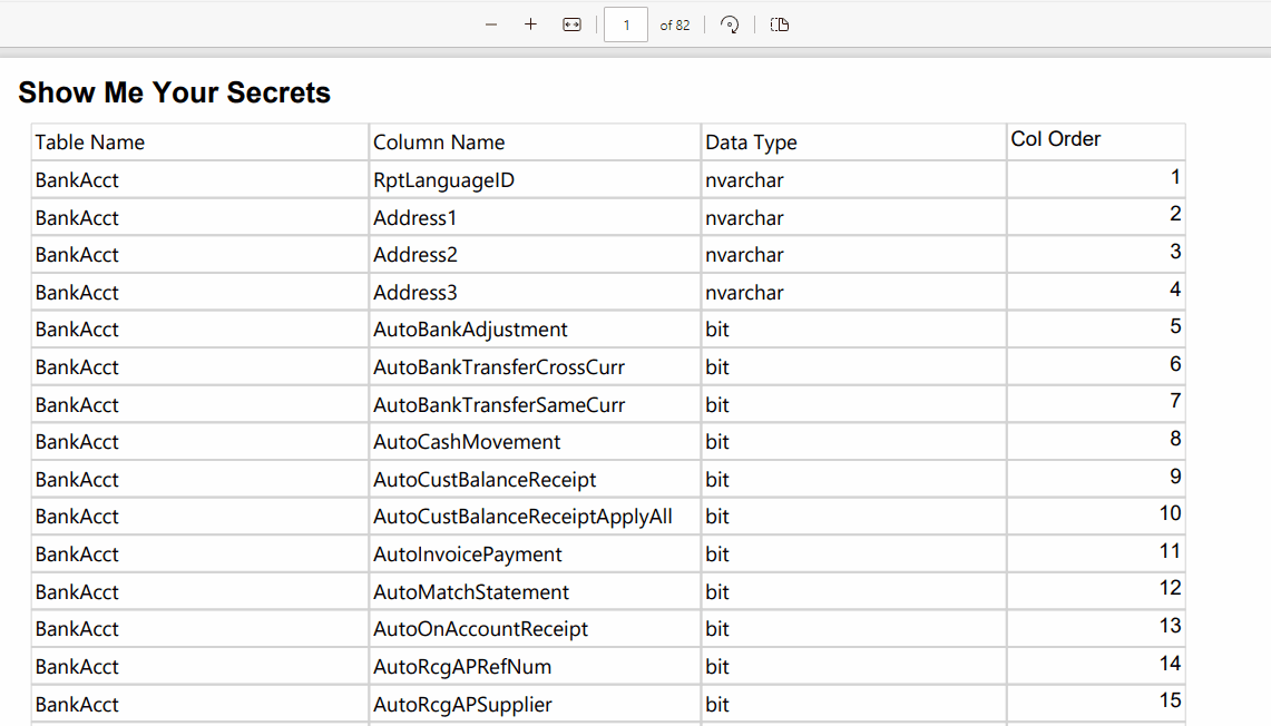

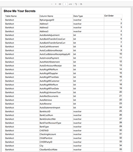

Have you ever just wanted a report of all of the tables and columns available in the dataset in SSRS? Trying to see if that RDD edit you made worked? Well now you have a new tool.
ShowMeYourSecrets
This report is completely generic. I will attach the report and show you how to roll your own.

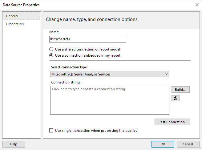

Add a Data Source to the report: IHaveSecrets
Jump To Post (Fixed)

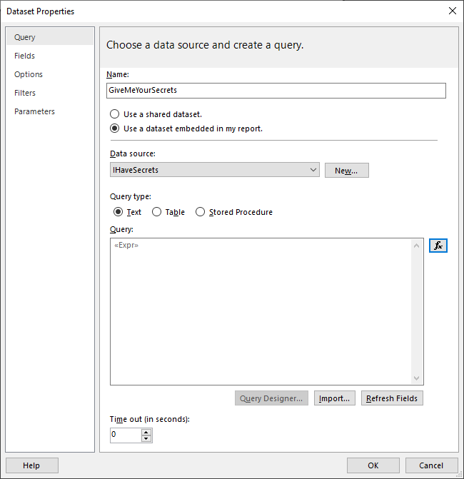

Add a Dataset to the report: GiveMeYourSecrets
Choose Use a dataset embedded in my report, and then choose IHaveSecrets
Add the Query Expression:

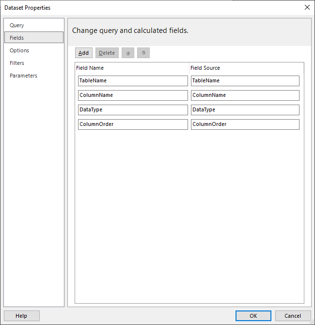

Add the fields:

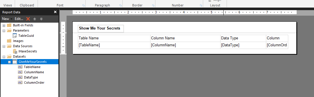

Then add a table to the report and adjust accordingly:

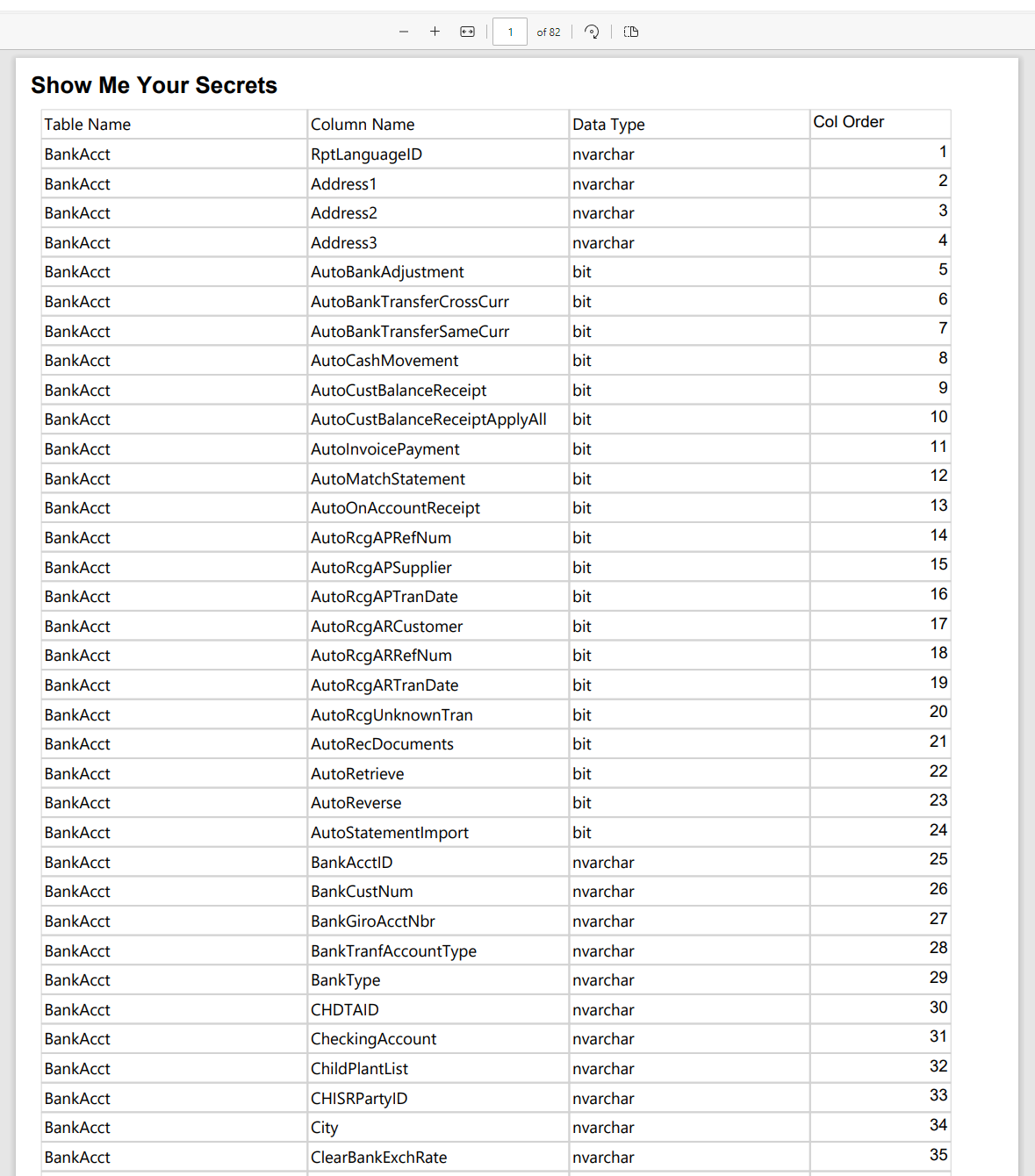

Your report is now ready for use. Choose that style to see all the fields.

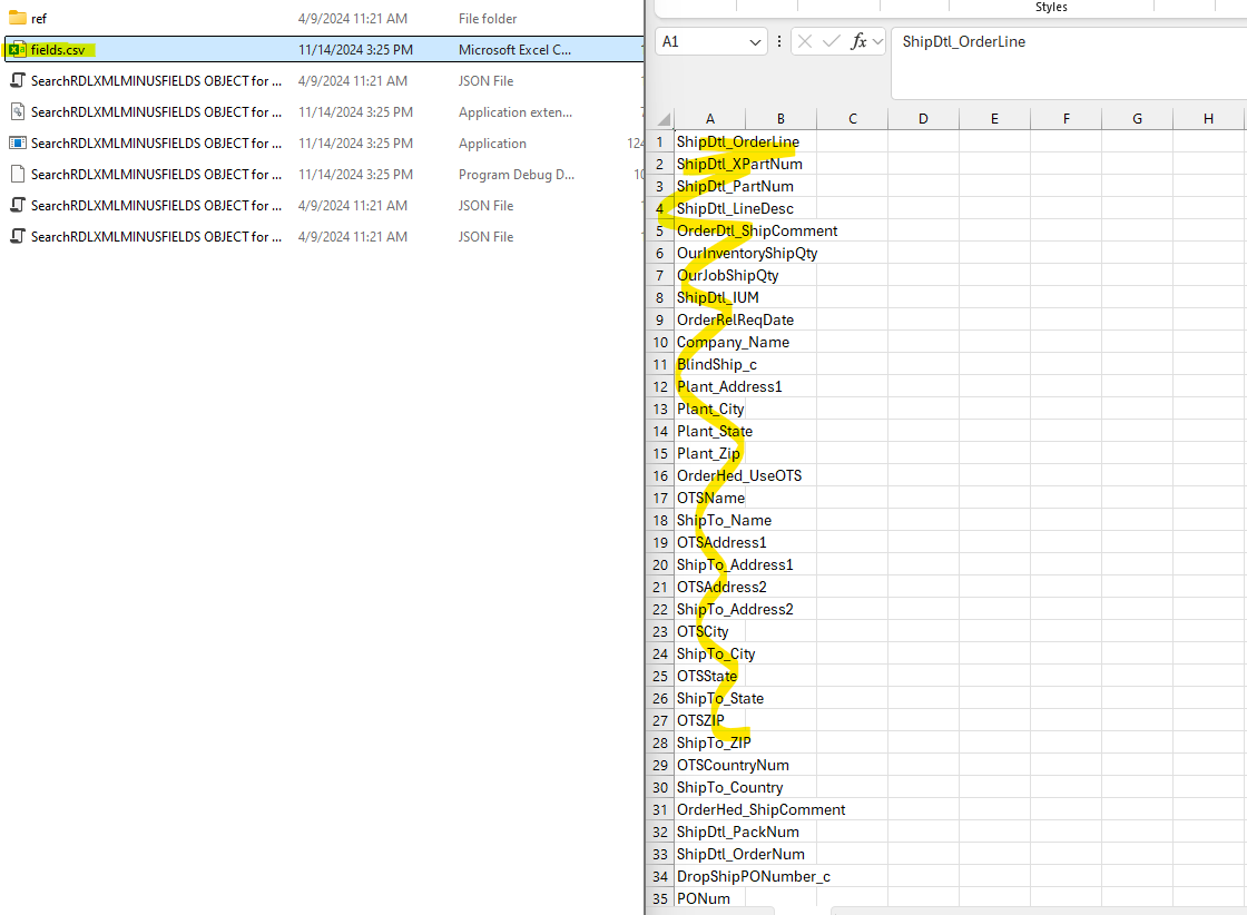

Don’t know if anyone misses the crystal functionality where it showed you if a field was used in a report, but I wrote this c# console app (with the help of AI) in visual studio to parse through the xml of an RDL and output the unique fields in a csv file. You just need to download your .rdl from the server and then change the file extension from .rdl to .xml and then put the path to your file in the code below. It will then output a csv file of all the unique fields that are being used. An actual developer would be able to pretty this up and make it more consumable for anyone and everyone, but here’s the code:

            Console.WriteLine($"Unique fields written to fields.csv.");
