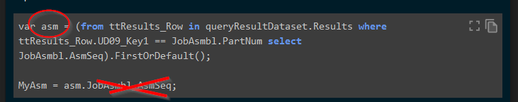

var asm = (from ttResults_Row in queryResultDataset.Results where ttResults_Row.UD09_Key1 == JobAsmbl.PartNum select JobAsmbl.AsmSeq).FirstOrDefault();
MyAsm = asm.JobAsmbl_AsmSeq;

You’re problem was that the variable type is an int… You are treating it like a row, but since you selected a single field, and the first row, it makes it right into the integer.
