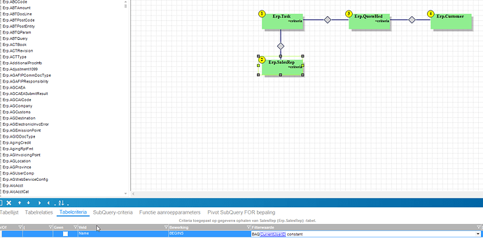

I have made a updateable dashboard where users have an overview of there quotes. The filter is based on a table criteria where the name of the salesRep begins with the BAQ currentUserID constant. But thats tricky when the UserID does not match the first name of the salesrep.
So i want to filter on SalesRepCode, from the CurrentUserID. Is that possible?
For now i have this:
As was mentioned above, UserFile is one way to get from the userid to a name. Another possible way to go from userid to SalesRep would be SalesAuth (authorized user) IF you have authorized users setup right.
We enforce territories using SalesAuth in a number of BAQs, linking the current user id to SalesAuth then to SalesRep (for View All Territories) or current user id to SalesAuth then to SalesTRP (for the specific territory)
