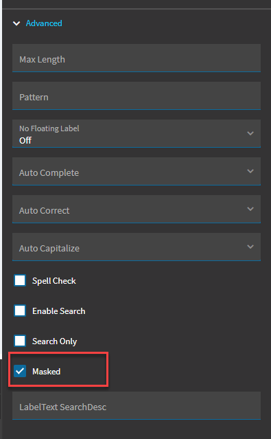

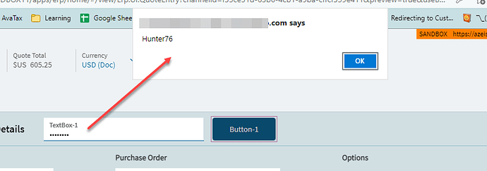

I’m an enabler. Here ya go, but you should probably heed Jose’s warning.
Bind your textbox to TransView.WhateverFieldNameYouWant
Then you can do whatever you want with that. No need to input the data and save, either, since TransView is runtime.
