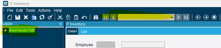

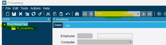

I’m working in the classic version and have used identical code in numerous places. I’m trying to load a specific record when a form loads (normally I’m using LaunchFormOptions and feeding the information in).
In this case, even when I hard code the information, it is loading the record, but not making it active.
I’m using this:
this.oTrans_adapter.ClearData();
this.oTrans_adapter.GetByID(key1,key2,“”,“”,“”);
oTrans.Update();
oTrans.NotifyAll();
And it is loading the record, it is not however making it the active record. On all other forms I’ve done this on, it not only loads but makes it the active record. This is on a form built off of UD29 but I have used this method in multiple other UD table forms. Is there a command to make a record in the tree the active record?
Is there a SetActiveRow command or something similar? I’m always going to be wanting the first record in this case so if I can do something like edvUD29.SetActiveRow(0); that would be perfect.
It’s not SetActiveRow, so do you by chance know the correct syntax?
