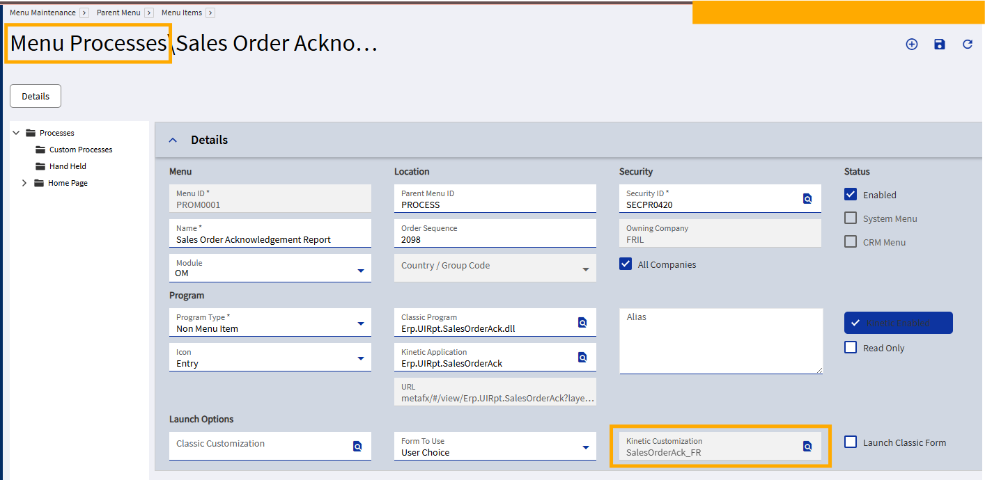

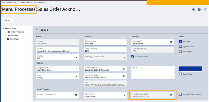

I replaced the Erp.UIRpt.SalesOrderAck slideout with a customized layer and after this update I kept getting an Error that “There is no active menu available for the app Erp.UIRpt.SalesOrderAck and layer SalesOrderAck_FR combination…”
I finally fixed that by adding this custom layer to the Process Menu for Erp.UIRpt.SalesOrderAck. It works again.
