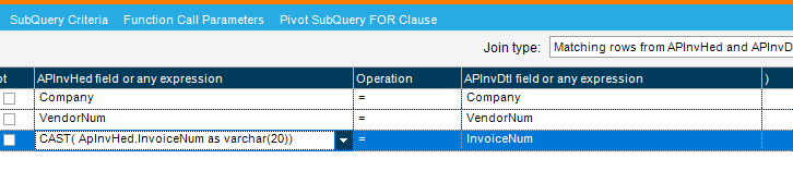

I am trying to create a BAQ that joins APInvHed to an innersubQuery ‘AddTotals’.
When I join them by InvoiceNum and add a field, I get the error:
Ice.Common.EpicorServerException: Conversion failed when converting the nvarchar value '#AUG2017' to data type int. ---> System.Data.SqlClient.SqlException: Conversion failed when converting the nvarchar value '#AUG2017' to data type int.

If I remove the join to the subQuery, the BAQ runs.
How do I stop the join from converting to INT?
