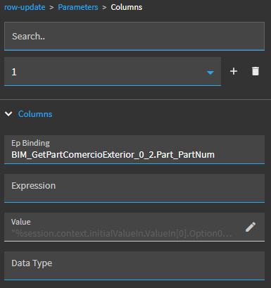

Here’s how I’m assigning the context to the dashboard parameter:
Value: “%session.context.initialValueIn.ValueIn[0].Option01%”
There are bugs and niggles with the web screens in the client.
Best bet it to run straight from the browser.
Can you run the debugger in the Client and see what (if anything) is being passed?
