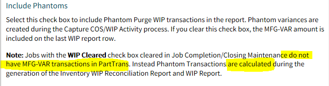

The WIP Report “Include Phantoms”, if CHECKED, means that it will show Zero WIP for closed jobs with “WIP Cleared” UNCHECKED. It knows that when CaptureCOS/WIP runs, it will create a MFG-VAR transaction to cancel the remaining WIP.
If Include Phantoms is UNCHECKED, then it doesn’t zero out WIP, it just shows the current PartTran balance.

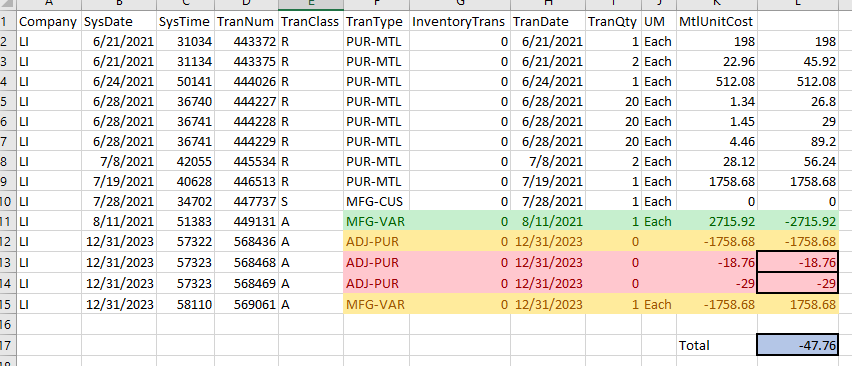

For example:
Here are all the the PartTran transactions on a job, which sum to -$47.76 (this is WIP, or difference from the job costs minus the value of shipped equipment).
For this job, on Job Closing, it is Completed/Closed, but WIP Cleared was UNCHECKED.
So when I run WIP Report with Include Phantoms UNCHECKED, it shows that there is -$47.76 WIP.
And when I run WIP Report with Include Phantoms CHECKED, it shows Zero WIP.

From Epicor help…
