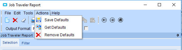

We saw the same thing with Order Entry. In our case, have the user open the Job Traveler print screen, go to actions and remove defaults.

what is being reset if I were to “remove defaults”?
Everything on the Selection and Filter tab for THIS REPORT ONLY. In our case, the filter had the one order number stuck. This is a by-user setting.

thank you…just wanted to make sure I understood what I was clearing.

To clarify- if the user is printing Job Travelers from Job Entry screen, will clearing the defaults in the Job Traveler window make any difference? This particular user just got a new PC and this continues to be an issue so I’m assuming it doesn’t have anything to do with cache on C:
Correct, because these options are stored with the user in the database. Have them move to another PC. If they get the old slip, clear the defaults. It’s only for that user and that report alone. It’s really a low-risk operation.

Thank you both! I cleared the defaults and will be waiting in anticipation. This is happening quite often so I’m sure I will find out if the issue is resolved soon.
