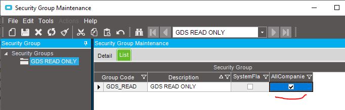

Thank you Mark for your suggestion. I created a group like you recommended. But ‘All companies’ is checked by default. When I try to unselect ‘All Companies’ and save, it gets selected again. Any idea, how to fix this?pic1
Security Groups are global, so I wouldn’t worry about that setting.
The more important thing is that you add this Security Group to the Security Tab of the Menu Item for the Company that it applies to. This is what actually controls the access to that menu item.
